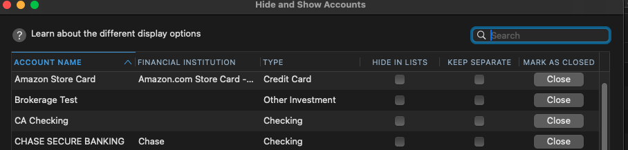

Thank you for letting us know you're seeing this issue. The unmapped bank ID (BID) the error is referring to is Fidelity NetBenefits. That error implies that Quicken is still seeing at least one account attempting to update on that connection.
To troubleshoot this, start by navigating to Accounts>Hide and Show Accounts…. In the window that comes up, check for any accounts that are connected using the no longer supported connection. If the account is connected, it will show which connection it is using in the Financial institution column.
If you find any that are still trying to use the Fidelity NetBenefits connection, make sure they are not hidden, then backup your Quicken file and deactivate the problem accounts. Once the problem accounts are deactivated, navigate to Accounts>Add Account… and follow the prompts. When you get to the Add/Link screen, carefully link your accounts to the existing account in Quicken.
If there are no accounts showing connected to Fidelity NetBenefits, then backup your Quicken file and deactivate all your Fidelity accounts. Then, navigate to Accounts>Add Account… and follow the prompts. Once you get to the Add/Link screen, make sure to carefully link the accounts to the existing accounts in Quicken.
