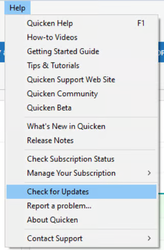

The forced cutover from Direct Connect to Express Web Connect+ for Merrill Lynch has already passed. I did notice that you’re still running R64.25, which is likely why you’re not seeing the prompt to migrate.
Please update Quicken to the latest version of R64.35 by going to Help > Check for Updates.
Once updated, launch a One Step Update again, and see if you receive the prompt to migrate your account.
