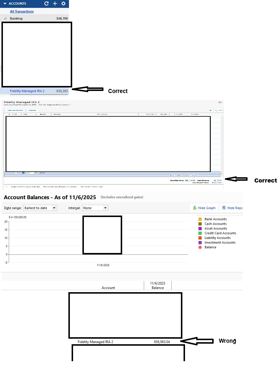

For one of my IRA accounts, the cash balances are all correct in Investing and Transactions. But when I run Net Worth Reports or look in the Dashboard, this account shows about $30K more cash. How do I troubleshoot this. I do not think it has anything to do with all the current Fidelity issues since everywhere else in Quicken the account looks correct.

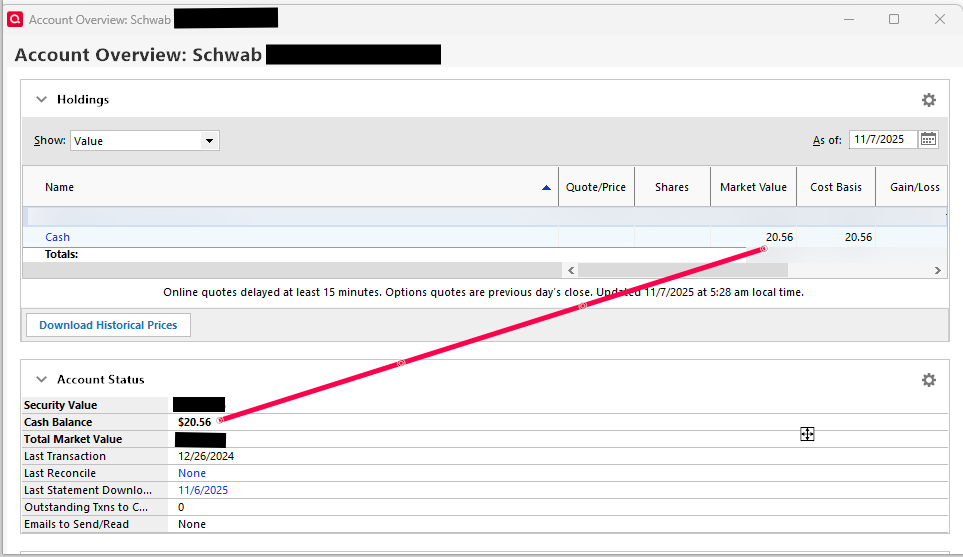

Within the Account itself, is the amount of cash shown consistent in all the places where cash is shown; in the security listing under Holdings, in the Account Status below the detail listing, and in the "Cash Balance" shown right below the last entry in the Transaction List?

Yes, the cash holdings amount is correct at $9K. If you look at Reports - Net Worth - Account Balances, that specific account is overstated there by $26K. The total holdings under the Accounts column is correct as is the portfolio breakdown under Investing. When you look at the total Reports - Investing - Portfolio Value, the summarized "Cash" line is overstated by the $26K. Attached is a rather lengthy pictoral of the values mentioned.
Off hand the only other place "cash" for an Investment Account is shown is in the Account Status of the Account Overview, and I have seen instances where that number was "off", though I don't remember how this particular error expressed itself elsewhere, like in reports.
