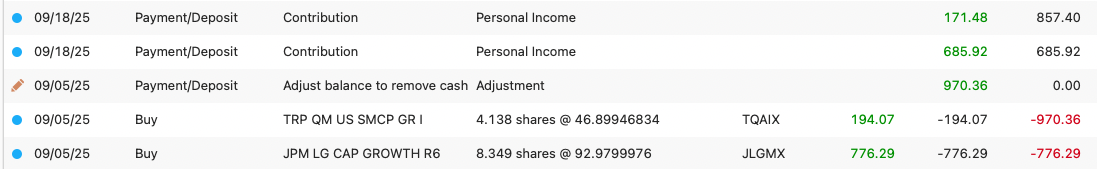

Another strange issue, again, since the connection update on one NetBenefits account, all new transactions that used to be "buys" with all the security details are now just payments/contributions/personal income with no security information. I would hate to have to start over on this one unless there is a straightforward way to import an account's history when things like this happen (hopefully it doesn't happen too often).
But now all new contributions look like the top 2 lines, whereas before, things worked as expected:
And this has persisted.

Based on the transactions, this looks like a 401k with your paycheck contributions.) And, no, your Buys should continue to be buys. But when Fidelity first cutover to the new connection method, many (if not most) users were getting a few random Payments/contributions instead. (I was personally getting 3 such transactions that didn't even align with my usual 9 different funds that typically occurred. This went on for about 6-8 week, but is now resolved-at least from what most people are reporting .You might see continued Buys later when the fix occurred.
Since I knew what was going on, I simply (after I merged securities) went to the Fidelity website and downloaded the transaction date range and manually typed in the buys with the corresponding amounts/shares purchased. I then deleted all those random payment transx. I felt this was the fastest way than waiting for a fix/having an incorrect file. I don't think their fixes are retroactive, so while it may be working now, you will have to manually enter the missing transaction for that data range of weirdness.
If you go this route, you will want to make a backup of your data file before attempting anything.
Sweet, that's easy enough, and I appreciate the insight! I'm a backup obsessor, so I'll give it a shot. At least the dollar amounts are correct, and it's just a matter of changing with a few clicks. Gosh, this has been an adventure…at least with Fidelity. Hopefully, we get back to steady-state soon!
