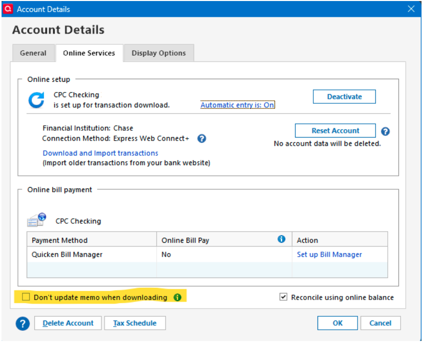

Which looking at that there is an option that does exist in the non-investment accounts that they probably could put in pretty easily (seriously doubt they are going to even think about a renaming rule), and that is an option to ignore the memo field.
As shown the account details of a checking account.
