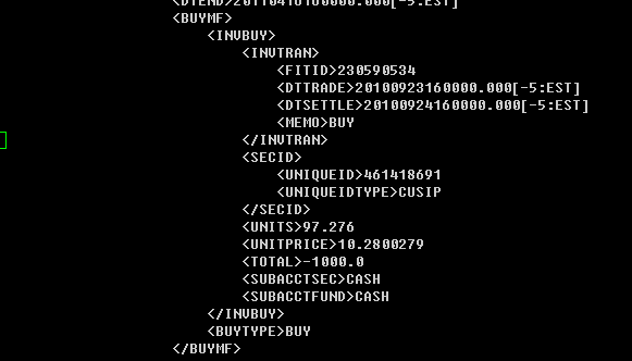

Here is a "pretty formatted of one such transaction" (normally Vanguard QFX transactions have no line breaks or indenting). The UNITS are the number of shares, and in no case do I see them exceeding three digits after the decimal point. The share price on the other hand has much more digits but really doesn't count since it will quickly be replaced. I think Quicken just does its own math based on the total/fees and the number of shares.
