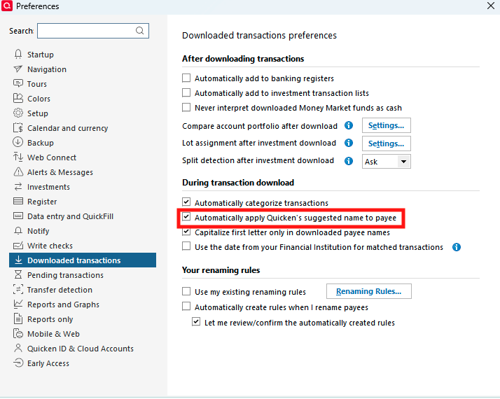

To help troubleshoot, please provide more information. Did everything change to the same payee name, or did they change to different (but incorrect) payee names? When you right click on the transactions with incorrect payee names, do you see a Revert to option? If you do, does it show the correct payee?
It is possible for Quicken to rename payees without having renaming rules set up. According to our article, if you have renaming rules, it'll use those first. If you don't have renaming rules set up, Quicken does have a database of standardized merchant names that it can use to rename downloaded payees. If that feature is on, you can turn it off by going to Edit>Preferences>Downloaded transactions, and unselecting Automatically apply Quicken's suggested name to payee.

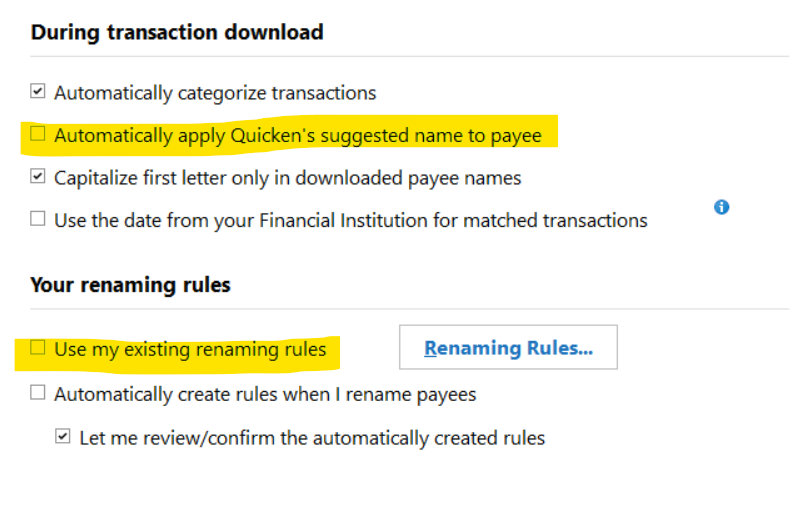

Note that I also experience this issue seemingly on a random basis on individual transactions within different accounts. I removed all renaming rules and disabled the options years ago and it worked fine. But at some point over the last few months something has changed. For me the work around is to right click on the individual transactions & select revert within the downloaded transactions interface. It is normally quite evident which transactions have been renamed. But something changed here.
