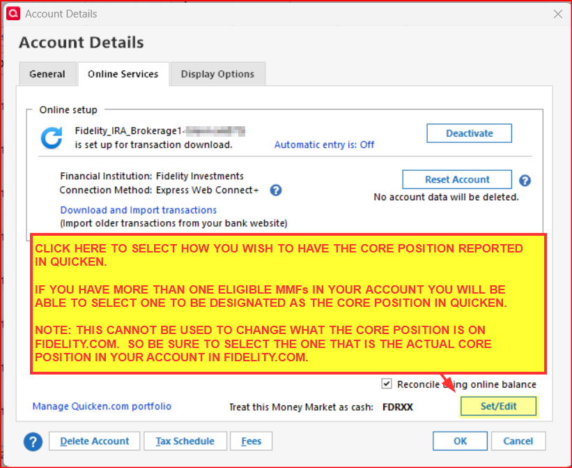

    Go to the Online Services tab of Account Details where you should see a newly added "Set/Edit" button. Click on that button to select how you want the Core Position reported in Quicken.
