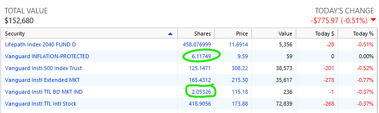

Merrill Lynch - Incorrect Investment Account Balance on 401K Bond Funds - shares off by 100x

    The issue started in October 2025 when the account moved to Express Web Connect. At that time, it also changed the Tracking Method for the account as Simple - Positions Only as the only supported setting. This is when the issue started to occur.
    I should also add that the issue happens only with my Merrill Lynch Benefits Online 401K account and not with any of my Merrill Lynch Investments or Fidelity Investments accounts, which have the Tracking Method as Complete - Positions and Transactions.
    The data file is located on my hard drive, and it is also backed up by OneDrive.
    Here is a screenshot of the issue, which I have circled in green. If you multiply the shares by 100, the positions and Total Value would be correct.
