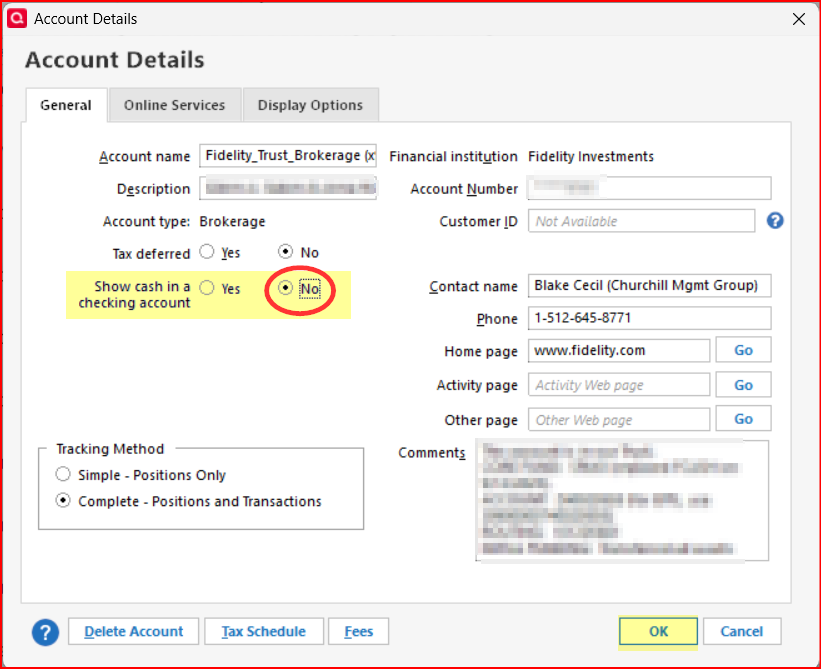

Are the investment accounts taxable accounts or are they retirement accounts?
If they are investment accounts, do you have them set up to show cash in separate checking accounts? If so, you might want to try backing up your data file and then changing one of the accounts that is causing the issue to not have cash shown in a separate checking account. Then see if the issue still exists for that one account.
I checked the accounts and none of them are marked Yes.
