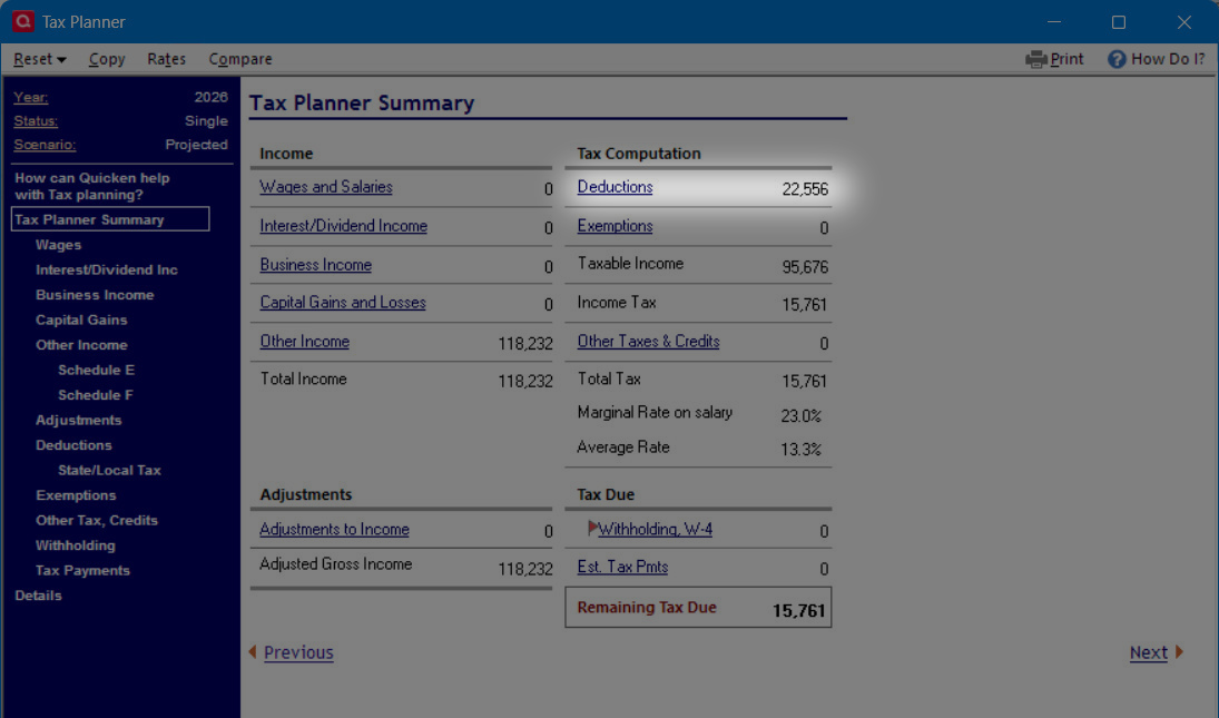

Maybe someone can verify this. For a single filing senior with an income of 118231.86, the total standard deduction calculated by my spreadsheet and chatgpt is $21556.09. However, the Quicken Tax Planner shows it to be $22556.

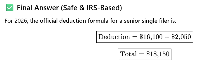

From chatgpt:

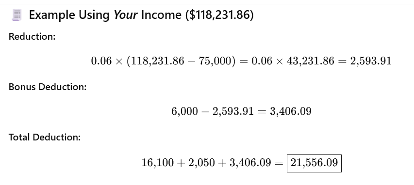

My spreadsheet formula: =16100+2050+(6000-(118231.86-75000)*0.06) =21556.09
The error occurs because the Tax planner incorrectly states the single filer senior standard deduction is $19150 and it should be $18150.
From Quicken Tax Planner Deduction drilldown:
From chatgpt and my spreadsheet:

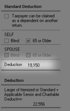

Yes. My rates also show $16100 for single filer in 2026, but the total standard deduction is incorrect. It should be $16100 + 2050 = $18150. Instead it is $19150. I tried another PC and the error still remains. I also tried a different datafile and the error remains. A file validate did not fix the problem I will try a clean re-install.

That is definitely making the difference. When I change Charitable contributions to $0. The correct standard deduction displays. I think you addressed the correct area of confusion. Thank you! I wish Quicken would describe its deduction calculation. Also, I can't get No Project Amount to stick for Charitable Contributions, but at least I can do User Entered.
Chatting with support. If there are no current year transactions, the tax planner reverts to the prior years' data in the Projected scenario. This applies to Interest income and Charitable donations. I got around it by creating $0.00 placeholder transactions for 2026 in Charitable donations and interest income.
