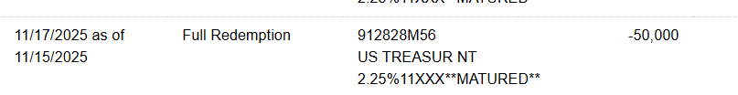

this was the initial transaction (Schwab)

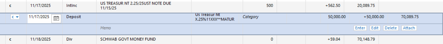

this is the Q transaction
what removed the shares?
how do i categorize the deposit?

The only way of removing a security that I'm aware of is via a Sold or Remove action, but you're saying the bond disappeared "magically?" Was the bond still in your Holdings on the 14th, 15th, 16th, and then disappeared on the 17th?
I suspect a placeholder got entered that effectively removed the shares.
Check your Preferences to be be sure your investments are set to show hidden transactions. If there is a placeholder you’ll be able to see it and delete it. Then you should be able to go the Sell pathway.
