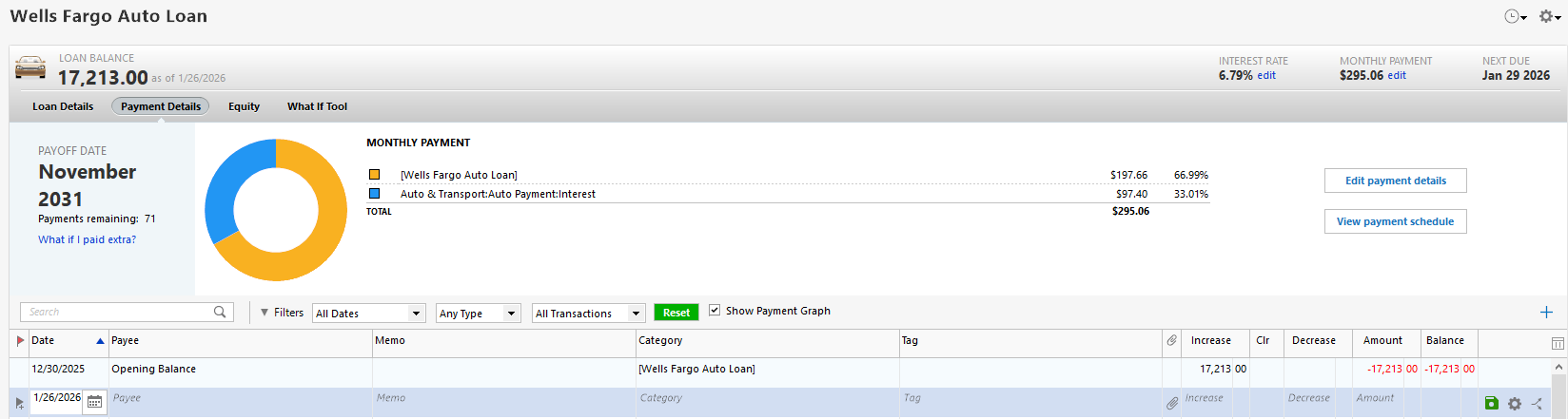

Today I opened Quicken to pay some bills and noticed that the terms for my auto loan were changed to random numbers. The correct payment amount is $291.73, for 72 months, with a payoff date of 12/29/31. That is what Quicken showed the last time I used it. Today, Quicken shows a payment due of $295.06, with 71 months, and a payoff date of 11/29/31. I have not yet made any payments on this loan. The loan is set up manually, not online. Why did Quicken suddenly change the details?
