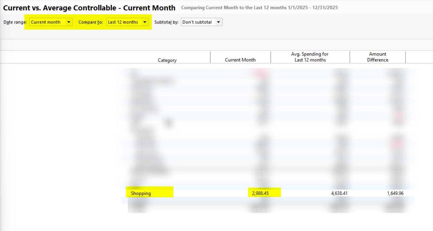

This report is broken. About half of the totals displayed do not match the totals if you click the category and drill down.

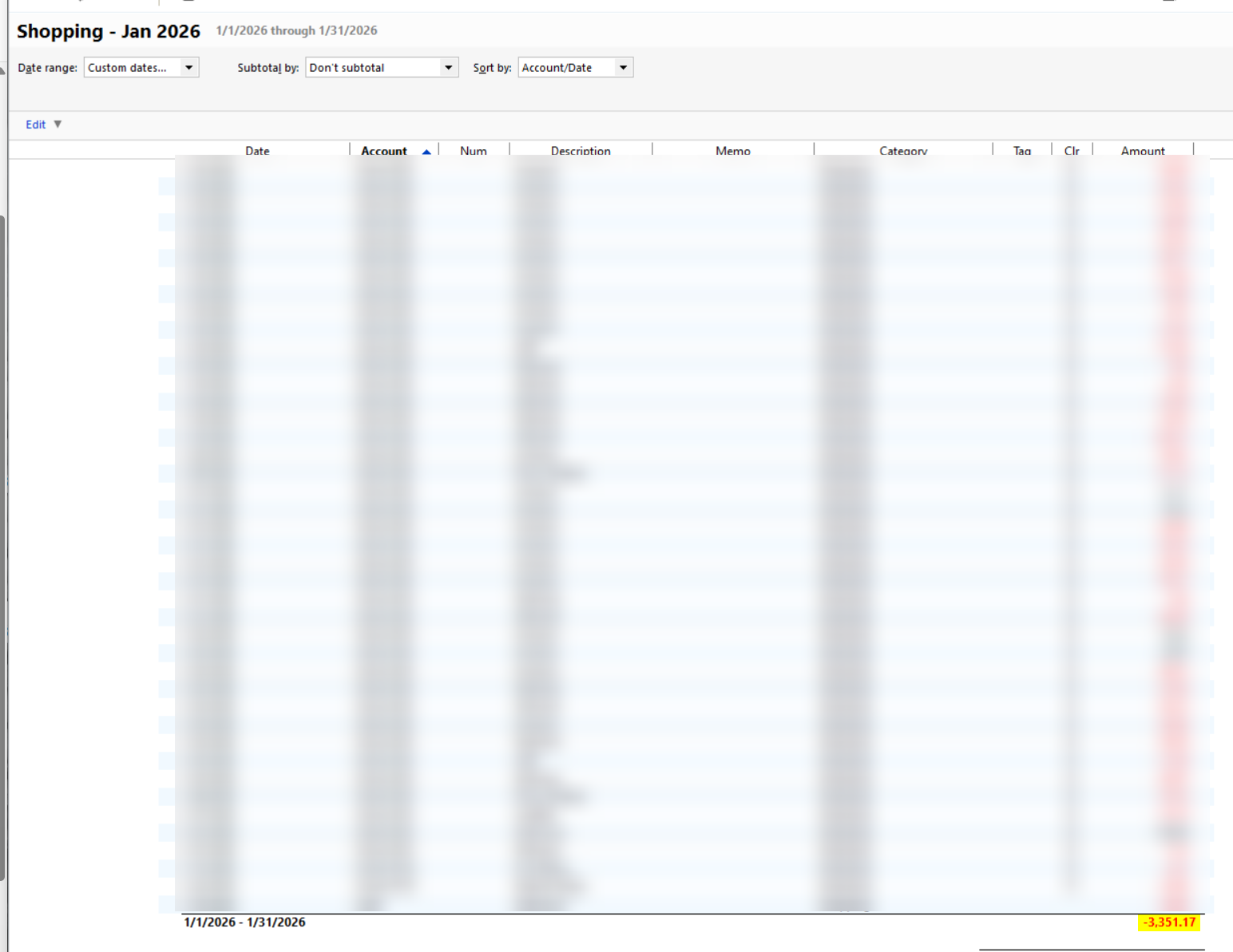

When I click on Shopping to drill down, the total for the current month is different:
I've verified that this second number is correct the first one, in the average report, is incorrect. Almost all of the categories do the same thing, but a couple of them are correct (or close to it).
