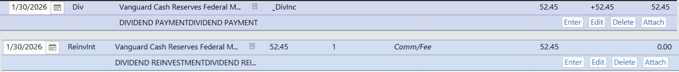

In the past, the Vanguard download created a Reinvest entry and reconciliation worked fine.
Today, for the first time, all Reinvest entries had a corresponding DIV entry. This equated to more cash being in the account.
For now, I deleted the DIV transactions and accepted the Reinvest entries and this worked fine.

    All my accounts have come in as Reinvest in the past without issue. Sample of the two entries.

    Previously, for dividends reinvested, Vanguard would send one transaction, ReinvDiv. Now they send 2: ReinvInt (interest, not dividend) AND Div. This creates 2 problems. The Div transaction improperly increases my accounts' cash balances and it is recording the other transaction as interest instead of dividends.
    I download my transactions in a QFX file (as I've been doing with Vanguard for years). I have 2 Vanguard accounts and my partner also has 2 accounts. All 4 accounts are affected by this problem. I think it first occurred about 2 weeks ago.

    Add me to the list. Vanguard downloads that should be single entry Dividend Reinvest transactions are shown in Quicken as two transactions: a) an income dividend payment added to the account cash balance and b) a separate interest re-investment of the dividend amount. So the share balance is correct but there should not be any cash balance.
    I also made a .csv download, there are two entries, a dividend received of, say, $10 and a matching dividend reinvestment of -$10. I don't know why Quicken is assuming an interest re-invest.
