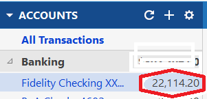

Only now the Balance that Quicken shows for this account on the left is double! That's right, the register is correct but the account in the "Accounts List" shows a double-balance.
Here is the adjusting entry with the correct balance in the register:
and here is what the account list shows:
Holy crap! As I was putting this post together Quicken suddenly started displaying the right balance on the left.
So, I guess the balances match - how should I be handling these CvrShrtX transactions?
