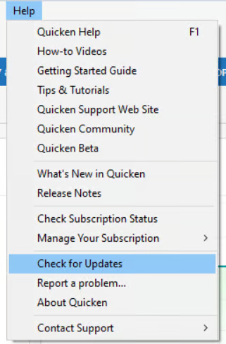

Hello @earlem,
Thank you for coming back to share the update—I’m glad to hear that reinstalling the .NET frameworks resolved the issue for you.
Additionally, crash-related issues were addressed in the latest R66.12 release. If you haven’t already done so, we recommend updating via Help > Check for Updates to ensure you’re running the most current version available.
We appreciate you sharing what worked—that may be helpful to others who encounter similar behavior.
