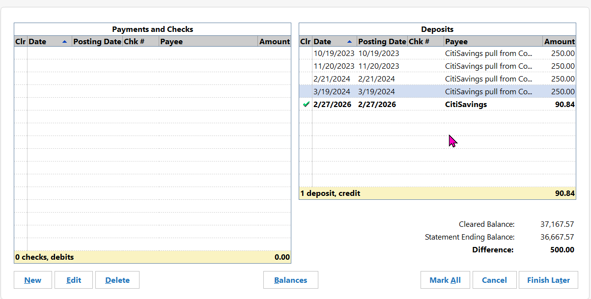

ETA: Oh, and it gets worse! I was reconciling a savings account and it says the balance is off by $500 (see below). Each of these "uncleared" transactions are NEW (with no posting date) and are duplicates of previously reconciled transactions.

- Since the issue appears to start with Oct 2023 I would start there and scroll forward looking for Duplicate Transactions. Since there are four $250 uncleared transactions showing in the reconciliation it is a pretty good indication that those are duplicates but there might be others. If any are found, decide which one to keep and then delete the other.

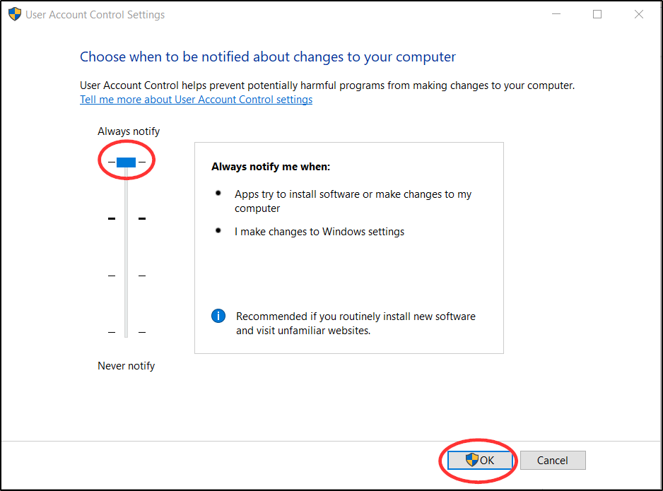

Thanks for the tips! How does one stop Quick from auto-applying software updates, so that I can download and manually install at my leisure? Seems like I'm not given a choice when I launch Quicken, and start One-Step update, when there's an software update available.
Quicken does not give us that option but Windows does. Update your Windows UAC Settings to Always notify as shown in the following picture. When Quicken tries to force update your installation you will be prompted to decide whether or not to let the update proceed. Works like a charm.:

The UAC setting is a great tip! I bumped it one level to MAX. Thank you!!

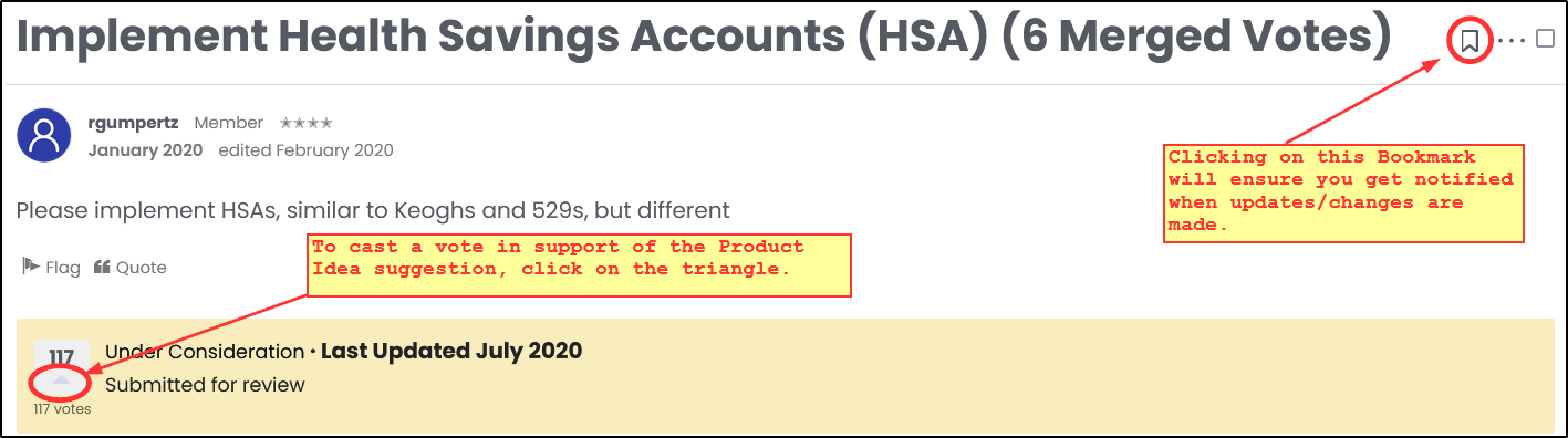

Seems like adding the option to delay would be a great feature enhancement request for Quicken. I wonder where one might submit such a request…. (adding this to the mental list of RFE's I'd like to submit).
You can submit Product Ideas by going to and then clicking on the New Idea button. Other users are then able to view the request and if they like the idea they can cast their vote for it. The Quicken Team does review requests that are submitted. Generally, they do not take any action with regard to them until there have been about 50 votes cast for it. Then they will take it into consideration and decide whether or not to add the idea to their Development Plan.
If you decide to submit a Product Idea be sure to cast your vote for it. Below the original post that you submit there will be a voting button as shown in the following example picture. Click on that voting button to cast your vote for it.
It is also suggested that before you submit a Product Idea you first conduct a search to see if someone has already done that. If so, then cast your vote for that one instead of submitting a new one.
