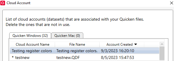

- Click Cloud accounts associated with this Quicken ID (#) (this is not a button; it is written in blue underneath the "Edit dataset name" button)
- Select the Cloud Account Name used for your main data file and click Delete
- Type Yes and click Delete
Once the cloud account is deleted, restore a good backup file and test to confirm that the issue is resolved.
