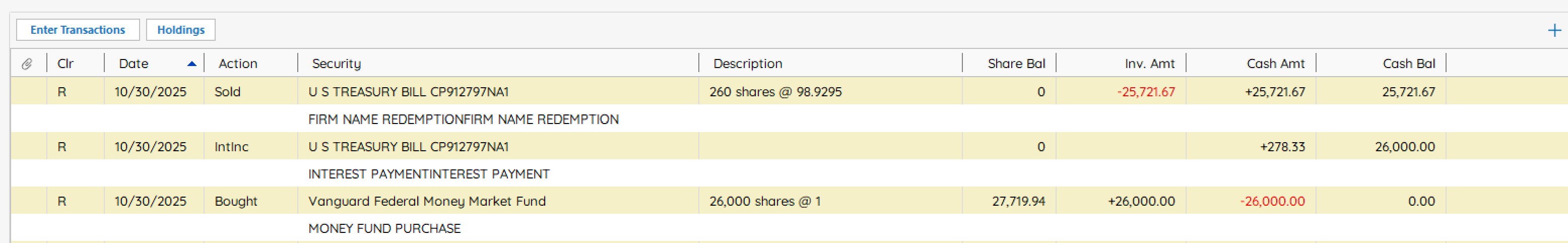

Tracking the final interest accrued is a somewhat laborious task if you are maintaining a T-Bill ladder, but can be done with some patience. If you are maintaining a ladder, you need to make sure the coupon number is captured in your register. You will need this to identify the bond's original purchase price so you can then calculate the interest. Below is how I enter the interest for a single bond as part of my T-Bill ladder.
The final proceeds (ie. $26,000) then go into a MMF to be used for repurchase. You can create an investment report to focus on just T-Bill interest to track progress.

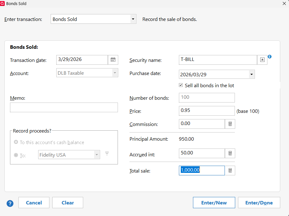

Thanks for the comments. I already knew it was accrued interest and not a realized gain. The issue I was struggling with was how to register it as such in Quicken using the buy and sold bonds feature. I figured out the needed modifications. Quicken needs to enhance bond transaction reporting.
I just did some experimenting, and I don't understand why you can't "Bonds Sold" the T-bill at cost and show the interest rec'd on the same transaction, as in my example.
