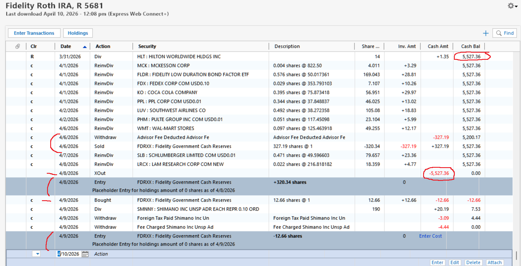

In March, Quicken wasn't even close to matching the cash balance in Fidelity's statement. Fidelity’s website had nearly 100 transactions in my account for March. Quicken has 74 because it combines Div and ReInvest into a single ReinvDiv transaction. For the first time, it had 7 placeholders, 3 XIn, 3 XOut, 4 Bought, and 3 Sold for FDRXX.

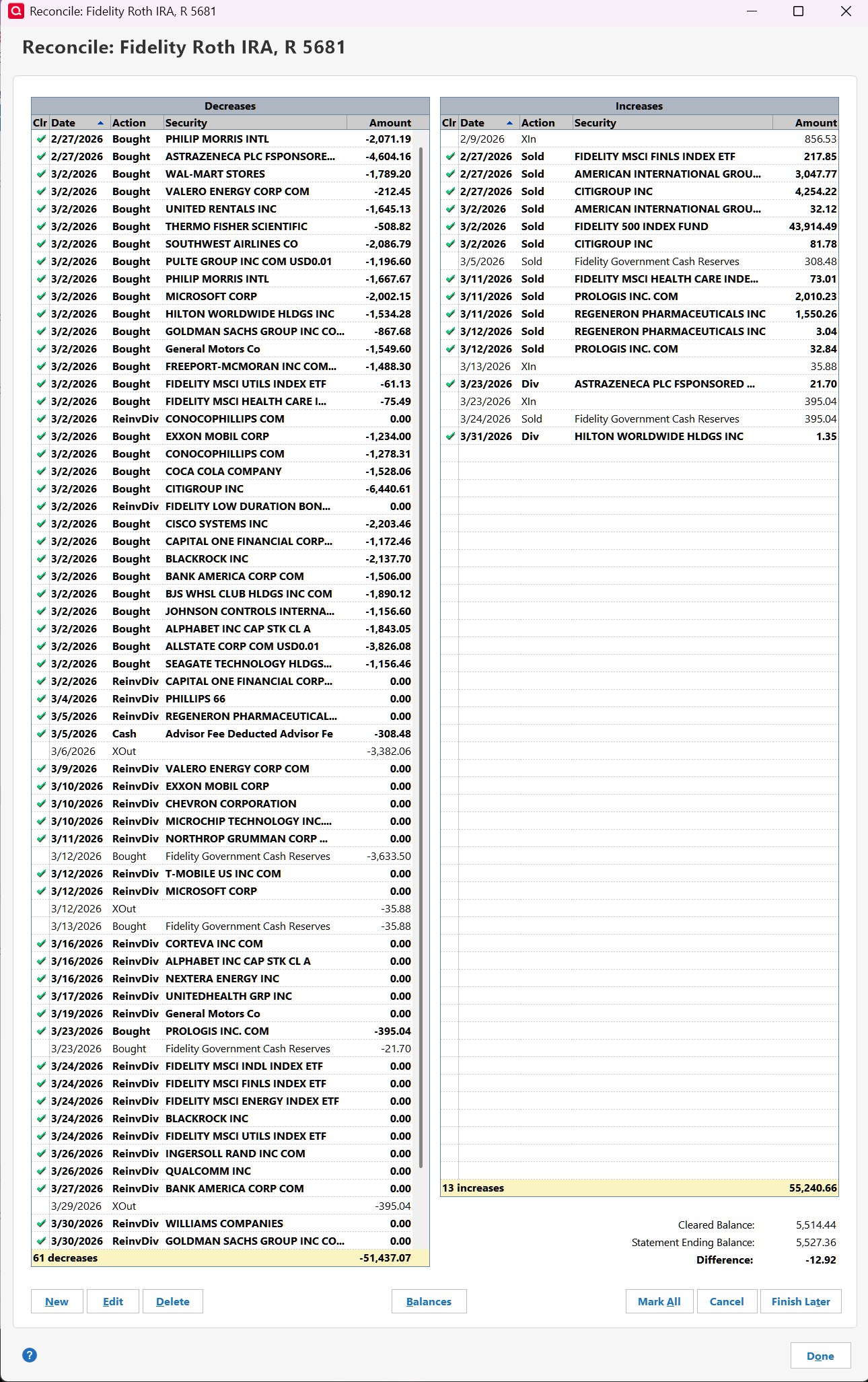

I opened the reconciliation panel, cleared all checkmarks, then checked each transaction in Fidelity's March statement. When finished, the Difference in the reconciliation panel was off by the amount of the FDRXX dividend, $12.92. As the 20 transactions weren’t in the statement, they remained unchecked. The screenshot shows the checkmarks.

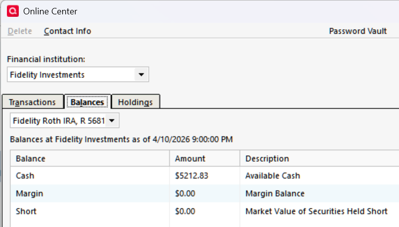

The statement cash balance was $5,527.36. BUT, Quickens register was $-12.92. I downloaded the register to a spreadsheet. I added a column next to the balance with a formula to compute the running balance by adding each transaction's amount to the preceding balance. When I deleted the amount from each of the 20 unreconciled transactions, the register balance returned to $5,527.36 less $12.92. The 20 transactions needed to be deleted.
In Quicken I deleted all the placeholders. Then, deleted all of the unreconciled transactions. The final balance was short by the dividend. Reinvesting the FDRXX divided into itself should increase the cash balance but it doesn’t. I changed the dividend from ReinvDiv to Div, which is how it was downloaded until February. Now, the balance is correct.

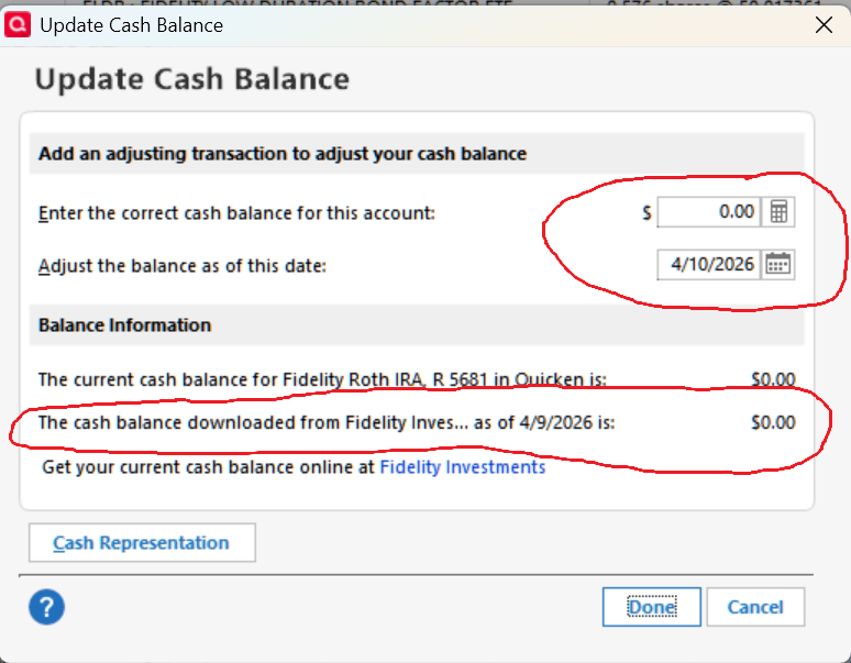

Quicken Cash Representation algorithm is bizarre. Why is it creating these 20 transactions? They are appearing this month too. After 8 months, I'd expect everything to work correctly. My Schwab account still has problems with cash representation after 8 years.
