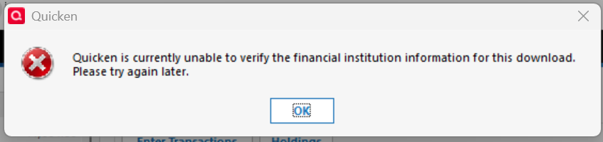

    I tried substituting the FI information of the "Credit Card" for the information for the "Credit Un". This is what I got when I tried to import it:
    I then tried with the "Credit Card" info and it worked.
    I tried with various flavors of "Credit Un" information:
    1. with information that I thought it should be from looking at fidir entry
    2. with the information from a QFX download of checking account. It was different from the one I generated from looking at the fidir entry in that
      1. the <FID> was not the same as the <INTU.BID>. The <FID> in the downloaded checking account QFX was not anything in the fidir entry.
      2. <ORG> was not an exact match of the text string in the fidir entry
    I then successfully imported the downloaded checking account QFX file.
    The checking account is activated through "Credit Card" but it will accept a download that seems to be from "Credit Un". I can't activate the credit card and it will accept downloads from "Credit Card" but not "Credit Un".
