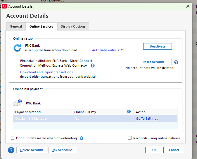

I am using Quicken Classic Premier on Windows 11Pro. For reason I cannot determine, my PNC Bank Direct Connection stopped working about three weeks ago. I have followed instructions to reestablish Direct Connect and enabled online payments, but when I attempt to Send a payment via direct connect, I receive a message: "You don't have an account that is enabled for online payments."
I have gone through the process several times, with the same results. I have pasted a screenshot of the account details below

    While PNC continues to offer Direct Connect, for whatever reason, you have currently established Express Web Connect+, which does not support online payments. I suspect that you may have switched during the PNC DC debacle.
    You need to Deactivate, then reactivate your account using DC.

    I have attempted to deactivate and reactivate. I have also followed the Quicken Instructions for accounts that were mistakenly migrated to Express Web Connect. I have tried several times, and tried to follow all the steps carefully and I still have Express Web Connect as the connection. I am designating the connection method as “Direct” when following the Quicken Instructions, but I have not been successful
