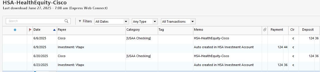

  • John McCurdy
    John McCurdy Member ✭✭
    @Tom Young - snippet with column names.

    Tom Young Quicken Windows Subscription SuperUser ✭✭✭✭✭
    edited June 27
    @John McCurdy

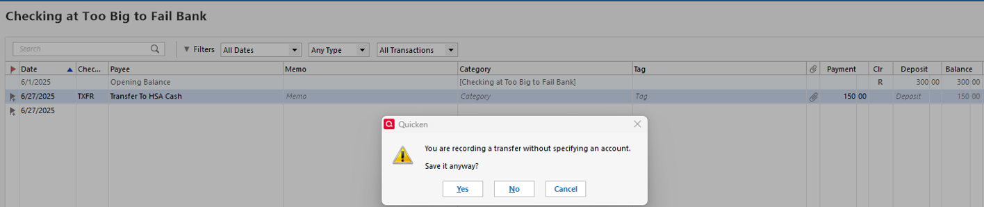

    The latest snipped shows that the transfers out have NO Category specified. I can only do that if I override Quicken's warning:
    Now that I think of it, I have in the past seen Quicken "auto create" three Checking Accounts. These were created when the downloading method for the "associated" existing Quicken Accounts - credit card and investment - were using one of the Express Web Connect downloading methods. That's what you might be experiencing here.
    ASSUMING that the actual cash flow is Employer Pay Check > Bank Account > HSA (cash) HealthEquity > Vanguard HSA then the last 3 transactions would be TRANSFERS with entries in the Category box being the name of the Quicken Account, surrounded by square brackets.
