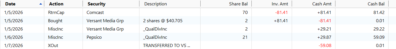

    Here's what I used. I own 70 shares of Comcast. Before these txn there was a $0.01 Cash Balance.

    @NotACPA How does your investment performance report look? Does the Investments column balance the returns as related to this spin-off?
  • NotACPA
    @q_lurker That negative MiscInc is "Cumulative _UnrlzdGain" on the spinoff. It was downloaded from Fidelity, as was all of the activity that I posted for the spin-off. Both before and after these txn, there was a $0.01 cash balance in the account.
    And, here's the snip from my Investment Performance report:
    And another stock also paid a $29.97 div on 1/6, which is why the cash xferred out is greater than generated by Versant.
