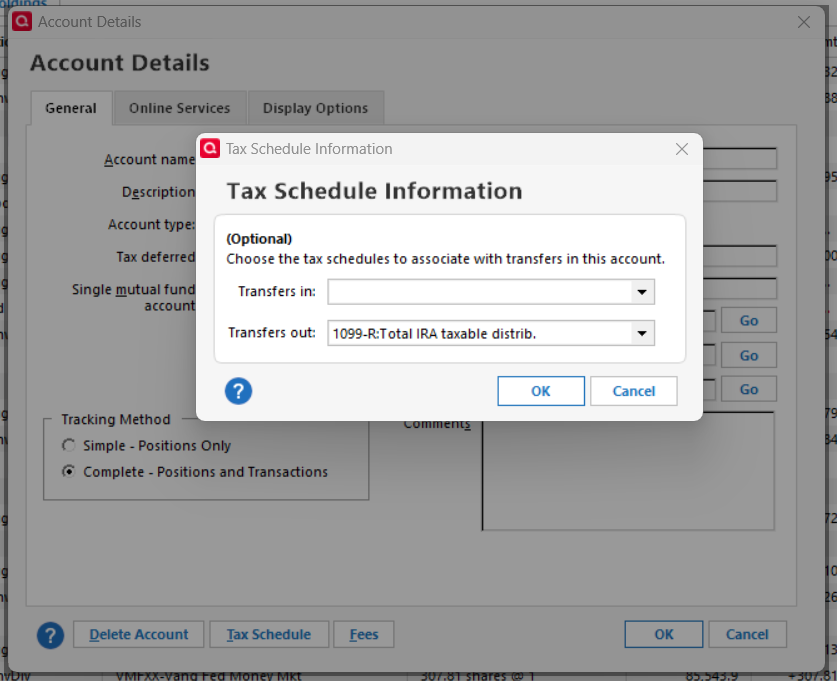

Is the "income" that you want to track the taxable distributions that you have received from your IRA accounts? That is different from income such as dividends that is generated by the securities in the IRA account, or non-taxable distributions from a Roth account.
If so, there is a specific procedure you must use when you enter these transactions in order for them to be recorded correctly in Quicken's Tax reports.
In the IRA, click on the gear at the top right and select Edit account details. Click on Tax Schedule and set Transfers out to 1099R: Total IRA taxable distrib., like this:
For the taxes to be recorded properly in Quicken, the transfer must be entered as a transaction in the receiving account. It can be a banking or an investing account, but it must be taxable, not another IRA for example.
In the receiving account:
1) Enter a Deposit transaction for the net amount of the RMD...a positive number.
2) Split the category:
- Line 1 of the split: Category = the IRA account name in [square brackets] and the gross distribution amount...a positive number.
- Line 2 of the split: Category = the Fed taxes withholding category that you use...a negative number.
- Line 3 of the split: Category = the State taxes category that you use...a negative number.
- Total of the split: Must equal the net amount of the deposit.
If you receive the distributions regularly, you can set this transaction up as an Income Reminder.
In the IRA account: Delete any downloaded brokerage transactions for
- The net distribution
- The Fed taxes withheld
- The State taxes withheld
With this setup, the taxable income will be shown in the “1099-R Total IRA Taxable distrib.” section of the Tax Schedule report.
