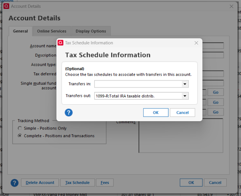

I'm doing my RMD withdraw but it is not showing up in the tax reports. My RMD is say $20,000 with 20% Fed WH and 10% State WH. In the IRA acct I do a gross $20,000 "Cash transfer out of acct" to the Trust (taxable) account. Now I open the Trust account, there is the Xin $20,000 amount. When I open it with "edit" button it does not allow me to do the split Fed & State WH lines? (I have a 401K account that I need to do the same.)

Here is a "Cheat sheet" for entering IRA distributions. Please see the bold section below.
In the IRA, click on the gear at the top right and select Edit account details. Click on Tax Schedule and set Transfers out to 1099R: Total IRA taxable distrib., like this:
For the taxes to be recorded properly in Quicken, the transfer must be entered as a transaction in the receiving account. It can be a banking or an investing account, but it must be a taxable account, not another IRA for example. If there is already an Xout transaction in the IRA account that transfers money to the taxable account, note the amount and delete it. Do not try to edit the receiving end of the transfer.

Finally, I see… So simple. I had the account setting correct. But trying everything as a transfer from the sending account first. Rather than working it as a Deposit in the RECEIVING account.
