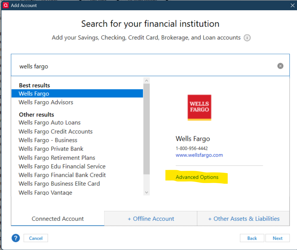

@Mike_L you don't say which financial institution your accounts are at, but usually you can just click on "Advanced Options" and change your connection method. But again, it depends on your financial institution.
I would first deactivate all your accounts with DC that you want to change to EWC. Go to the Online Services tab in Account Details and click on "Deactivate". Then go to the General tab and blank out the FI Name and Account Number.
Then to reactivate, go to "Add Account" and choose your financial institution(s) by typing in their name. The initial screen should have an "Advanced Options" link. But that again depends on what financial institution. Here is an example -
When you click on "Advance Options" it should take you to a screen with connection method options. Choose "Express Web Connect" and then proceed with the rest of the set up. When you get to the screen that lists out your accounts at the financial institution, make sure to link the accounts to the existing accounts on Quicken.

Advanced Options in Add Account is not available with every financial institution. It is only present when there are multiple connection methods available for that specific financial institution. It is also rather common for banks to have multiple financial institutions in Add Account…one for DC, one for EWC+, one for credit cards, one for loans, one for investments, etc.
If you would provide the name of your bank then perhaps we can confirm the specific Add Account financial institution that is to be used for EWC+.

@Mike_L I wanted to tell you that some financial institutions, the "Advanced Options" are a different place, usually on the sign on screen. So be sure to check there also.
