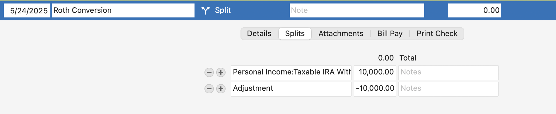

So how do you correctly record the transfer from the traditional IRA account to the Roth IRA account, and have Quicken count it as taxable income? Quicken Mac currently lacks a tool to do this, so you need to resort to a hack. In any non-retirement account — such as your checking account, or a non-retirement brokerage account; it doesn't matter what account you use — create a transaction with an amount of $0, and two split lines. The first split line should be the amount of the Roth conversion, with the Category="Personal Income:Taxable IRA Withdrawal". The second split line should be the negative of the amount, and use Category="Adjustment". Here's an example of a $10,000 Roth conversion:

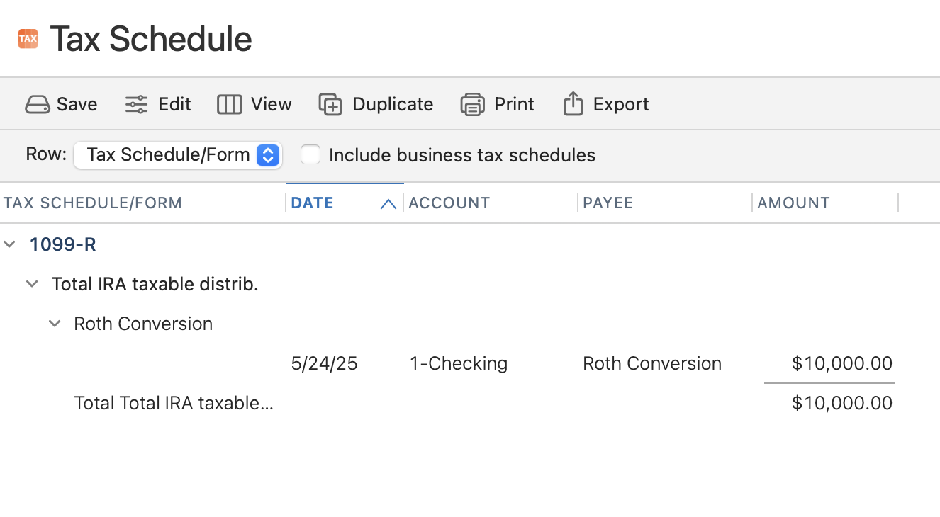

And here's how that shows up on the Tax Schedule report as 1099-R taxable retirement income:
Why does this work? The first split line creates the taxable IRA withdrawal income, so it's correctly reported on the tax report. But you don't actually have any income in this account, so the second split line makes the income "disappear", which is why the transaction itself is a zero dollar transaction which doesn't affect the balance of the account you put this transaction in. the category "Adjustment" is a special Quicken Mac category which doesn't show up as income or expense on any report. So it enables you to violate the rules of accounting by creating the taxable income out of thin air.
