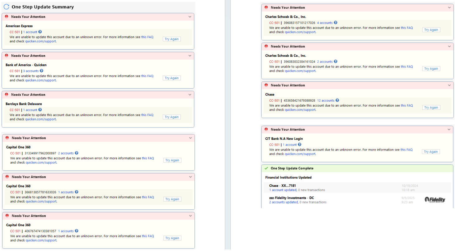

For the last 48 hours I have received CC-501s and have not been able to connect with the majority of my accounts at various institutions such as Chase, AMEX, Barclays, CapOne, Schwab, etc. (see attached screenshots). Interestingly, I am able to connect to SOME. Is anyone else seeing this?
Not sure if this is the right thread being a CC-501, but I saw this error code referenced in several responses, although not the title of the thread.
