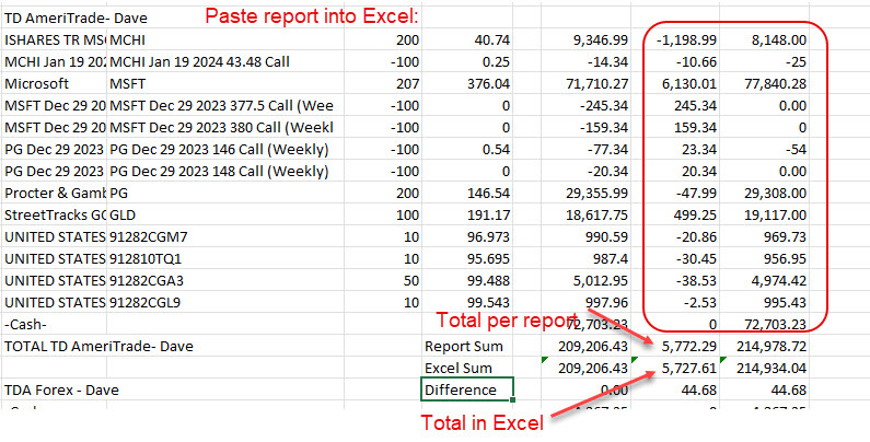

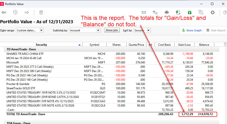

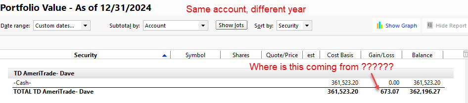

"Portfolio Value" report does not accurately sum the "gain/loss" and "balance" (market value) columns for all of the positions in the one of the accounts.
The attached screenshots illustrate the problem.
Here is additional background:
- The report is generated from the "Portfolio Value" template under the "Investing" section of "Reports and Graphs"
- The report is run directly from the template; it is not one of my saved reports
- The only customizations to the report are the date and subtotal by account
- Only the "gain/loss" and "balance" column totals are incorrect
- Only one account of several in the report appears to be affected
- I have not encountered the issue with this report previously
- After encountering the issue, I performed a super validation (w/o price history correction), closed Quicken, rebooted the computer then relaunched Quicken and ran the report again. The problem persists.

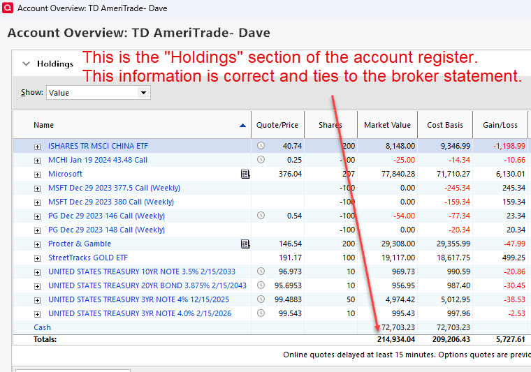

- The account data is correctly reported in the "Holdings" section of the account register; this information agrees to the brokerage statement.
- Quicken Classic PREMIER; Version R63.21; Build 27.1.63.21; Windows 11 Enterprise
I do not believe this is a "data corruption" problem. The data reported for the individual positions is correct. This appears to be a data aggregation problem within the report. The report has the correct data, it's just not summing it properly.
