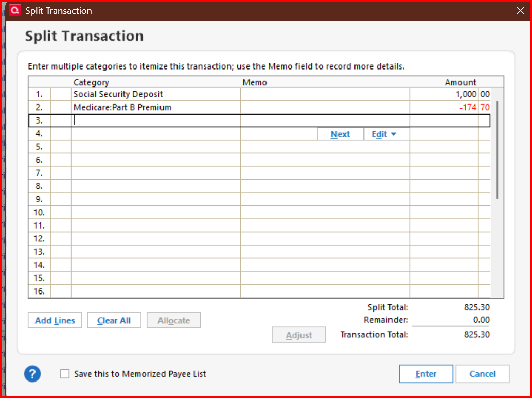

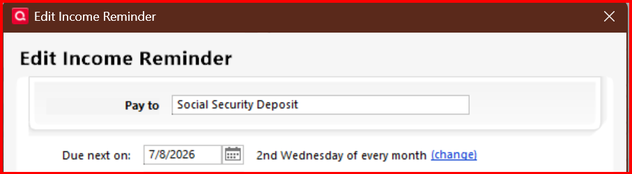

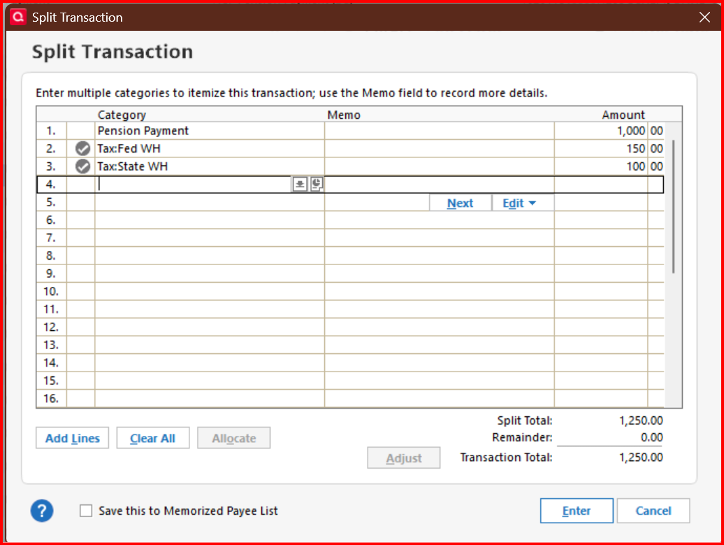

    Yes, using reminders is key to setting up pension and Social Security payments. The easiest thing to do is set up one transaction in your register then right click on the transaction and select "Add reminder".
    Here are some examples -

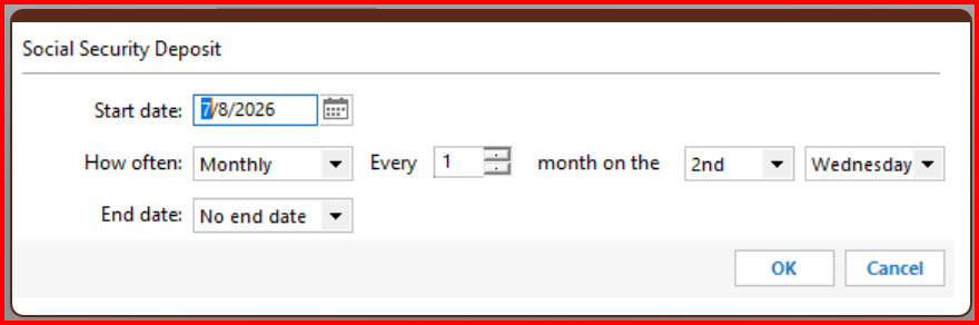

    When setting up the reminder schedule the payments you need to use a special schedule set up for Social Security payments. In the main screen click on "Change" -
    Then, in the options, change the "How often" to "Monthly", every "1" month. Then to choose the appropriate week (2nd, 3rd, or 4th), scroll all the way to the top of the dropdown list. Then in the last dropdown box, choose "Wednesday".
    If you have any other questions, please circle back. Again, there is no need to use the paycheck wizard and it would cause more issues than it's worth, in my opinion.

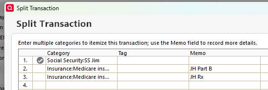

    The split transaction in the Reminder for my Social Security looks like this:
    The first line is the gross SS payment, a positive number, and the other lines are the deductions, entered as negative numbers. The tax line item for the income is Form 1040:Social Security income, self.
    Most people would probably also have additional deductions for Federal and state income tax withholding.
