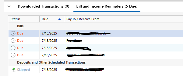

I have a deposit transaction scheduled for the 15th and the 30th of each month in one of my accounts. The transaction scheduled for the 15th disappears after I do a cloud sync. I did a reset of my cloud data and that did not help. This happens consistently and is very annoying. I am running on Windows 11 and I use the desktop subscription version. This looks like a bug!

It's a regular income reminder. I just noticed that it also happens when I one step update. :-(
If I re-edit this dialog and change the "Due next on" back to 7/15, it fixes it until the next time I update or sync. Very annoying! I've tried to remove and recreate the reminder and that has not helped.
Another thing I just noticed. After I add the correct next date back into the reminder, it mysteriously has a status of "skipped". Not sure if there is any way for me to change that.

Sadly, neither worked. As soon as I did a "one step update", the transaction disappeared. 😒

I came up with a work-around. I created two bimonthly payments (first and second) as separate payment transactions, and removed the original. It's not the best, but it seems to bypass the problem. I've done this the original way for a long time — don't know what introduced the issue.
