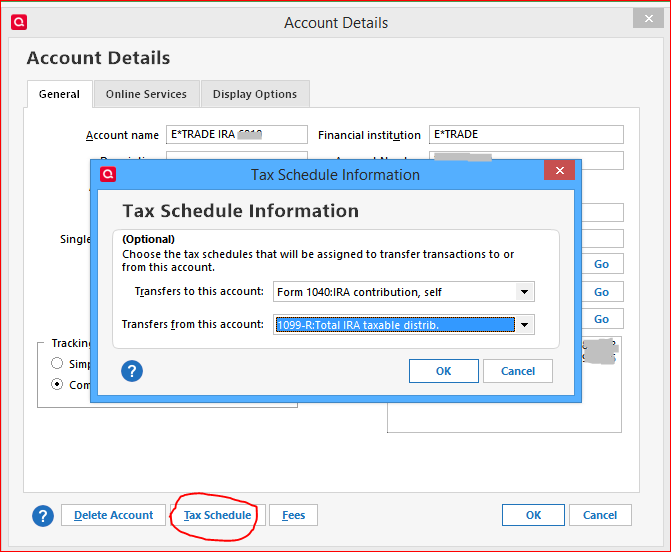

When you go into Edit Account Details for the IRA accounts and click on the Tax Schedule button at the bottom of the view, what tax categories show up in the two fields for Transfers In/Out?
AFAIK, for IRA accounts they should be something like below, for brokerage accounts they should be blank0 -
The brokrage account was blank already. I changed the Roth IRA's, but it didn't change anything in the planning budget.
