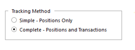

@OmniDIYer for each of the affected investment accounts, go to the General tab in Account Details and switch the Tracking Method to "Complete…"

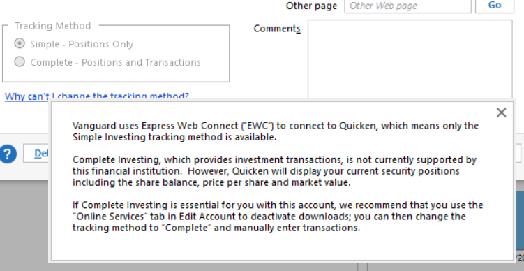

Two weeks ago, I had DECADES of transactions in register form.
Last week, all of that disappeared—and this is the explanation? With no warning?
And I would have to recreate this MANUALLY?
Is this a joke?
OR, you can leave Vanguard, which is imposing this onerous rule, and switch to an investment firm that supports Quicken better.
BTW, "Simple Investing' is NOT a requirement of EWC … Vanguard, who is sending you that message, is lying.
Quicken is merely passing along the message from Vanguard. And yes, that "manual" message is ridiculous.
