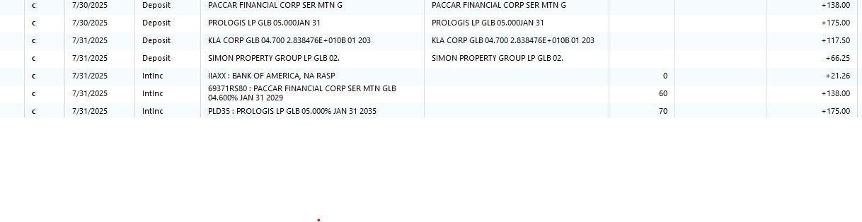

@Quicken Kristina — My issue is similar to @Melco. On one day I receive a "deposit" or "withdrawal" for an amount that is associated with security, and the next day I receive the "IntInc" or "Div" entry for the same security. When I compare to my online account, it appears that the first transaction is from the "pending" activity in ML and the second is the "cleared" transaction. I believe you need to stop the download of "pending" transactions for the investment accounts. At least for me that would clear up the issue.
I could not send a sanitized version of my file - it was too large, but here is a screenshot of what I am seeing. See the Paccar and Prologis entries on 7/30 and 7/31.

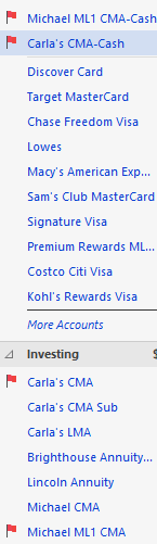

I don't think this related issue I just encountered has been reported, so here it is. I have two CMA accounts with separate registers for cash. When dividends are posted, they transfer from the main CMA account to the cash account. Today, I see that transfers were processed but reported not accepted in the cash account because there was no dialog box to accept them. Below is the dialog from the main account after accepting the transfer. The Continue button is new. I never got that before, but when I hit it, it switches to the cash account where there is no option to accept it.
Now I have the these accounts still flagged with unaccepted transactions with no way to clear them. Error report has been sent.

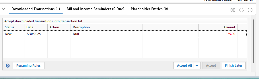

Those null pending transactions had appeared in the downloads in all the non-linked accounts before the validate and allowed me to delete them rather than accept them.

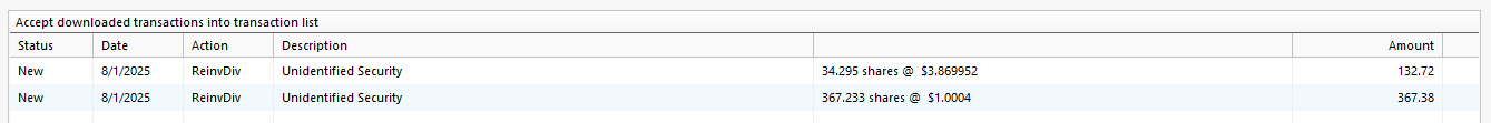

One other issue was that there were several transactions downloaded in the non-linked accounts for reinvested dividends, but with "unidentified security". I had to look up on the ML web site what they were for and then fill in the correct security. Non-reinvested dividends had the correct security, so different transaction types seem to have different issues.
It should also be noted that prior to this change I never got ReinvDiv transactions in the download. They all came as three separate transactions - the dividend, the added shares, and the reinvestment withdrawal from the cash balance. I would much prefer the single transaction going forward if the security field was correct.
New "null" pending transactions downloaded again today for all accounts having pending future withdrawals.

You mentioned that you're also seeing "unidentified security" download. Is this happening only with reinvested dividends, or have you observed this behavior with other transaction types also? I notice you included a screenshot of it with the problem report you sent yesterday. How does that "unidentified security" appear on Merrill Lynch's website?

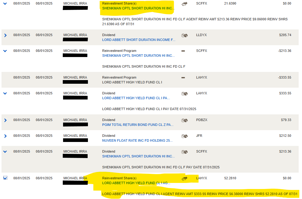

Here are the transactions related to the two reinvested dividends from the ML activity page for one the two accounts where this occurred. The ones highlighted in yellow had "unidentified security" in their download.
Note that there are two related transactions for each those titled "Dividend" and "Reinvestment Program". I remember the "dividend" transactions downloaded and matched OK on 7/31, then the reinvestment on 8/1.
The Merrill Lynch transaction downloads post change over to the new Express Web Connect+ security model is an acknowledged cluster. I spent way too much time troubleshooting what is an apparent known issue.

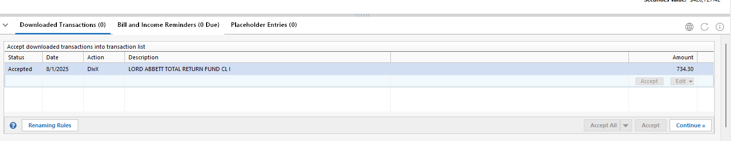

This is the type of issue I am seeing with dividends/reinvestment. My accounts are now a total un-repairable mess……….
