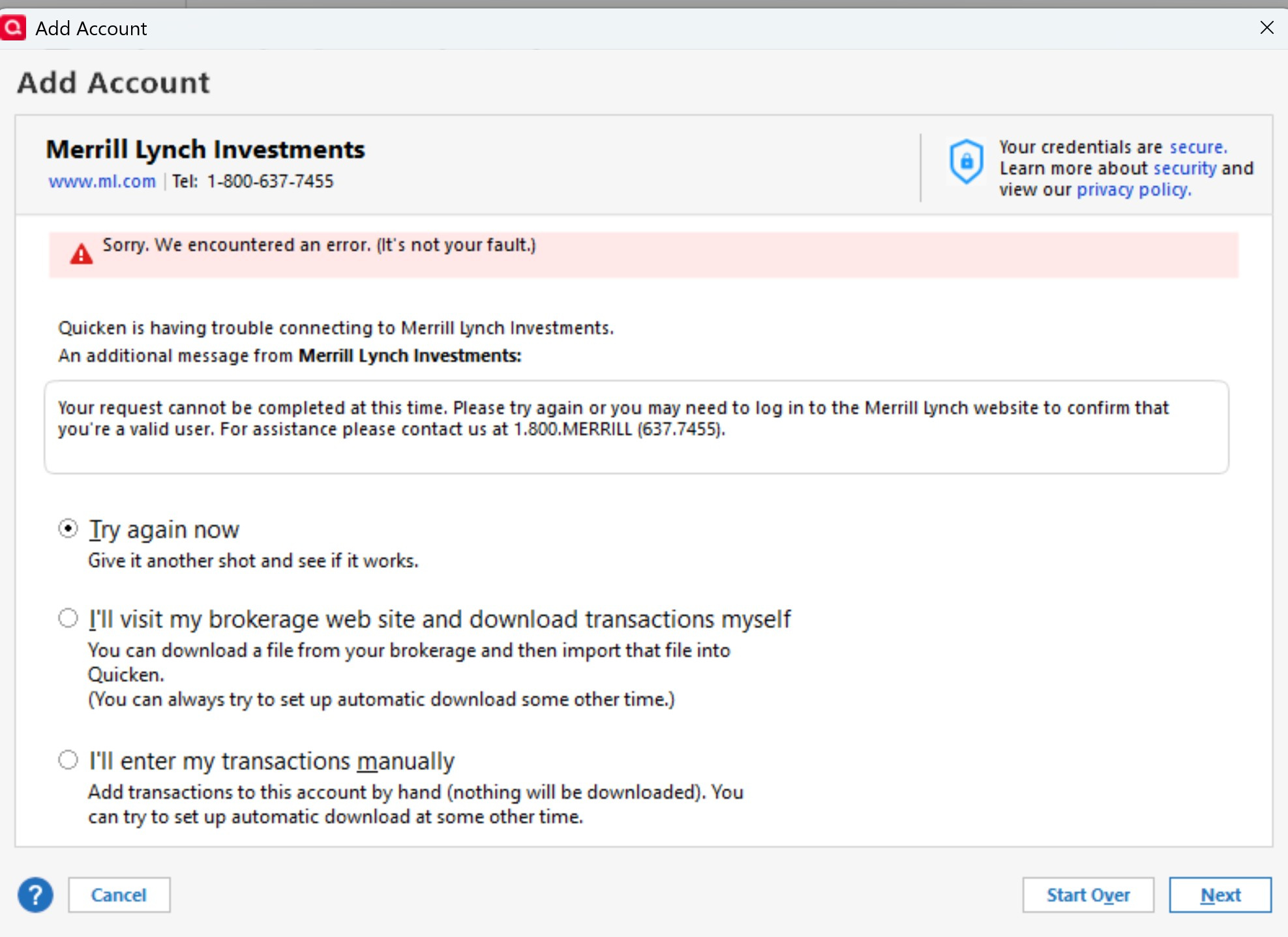

First, I created a new Quicken file and attempted to add the Merrill Lynch account. I tried to add it multiple times and each time I got the below error.

The error message you show from the new file looks like the error one would see when trying to connect via Direct Connect. Were you trying to connect via Direct Connect in that new file, or did you get redirected to the financial institution's website to authorize the connection?

I did not choose a connection type. I went to add an account, chose Merrill Lynch Investments, got prompted for my login info, got the error message.

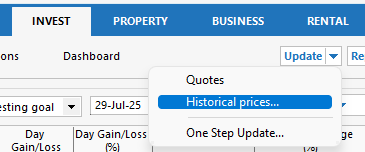

To fill in the missing price history, if you haven't already done so, please navigate to the Investing tab, click the Update dropdown, and select Historical prices….

Downloading historical prices did not fill in the missing prices.
