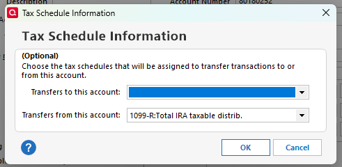

If you go to the Account Details for the IRA, click on Tax Schedule and set Transfers from this account like this
the total amount of the distribution should appear in the Tax Planner and tax reports.

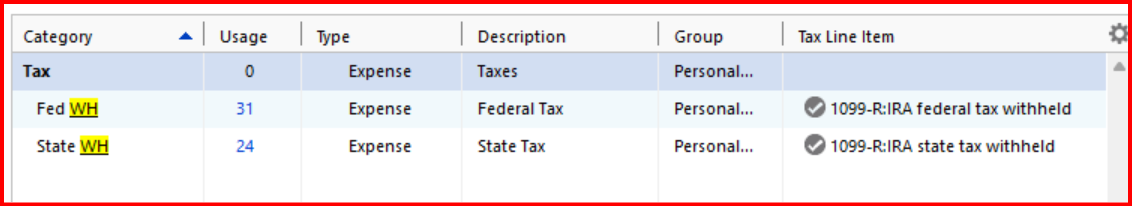

There are no built-in Categories for IRA tax withholding; you must set them up yourself. I use these:
- Tax Fed:Fed IRA WH with a tax line item of 1099-R:IRA federal tax withheld
- Tax State:State IRA WH with a tax line item of 1099-R:IRA state tax withheld
In the IRA, click on the gear at the top right and select Edit account details. Click on Tax Schedule and set Transfers out to "1099-R:Total IRA taxable distrib." If you don’t see the Tax Schedule button at the bottom of the Account Details dialog, click on View in the top menu and select “Tabs to show”. In the list of tabs, select Planning.

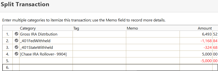

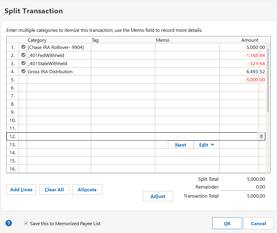

Does this look correct? What do I do if anything with the -5,000. BTW thanks for you help.
Try making the amount on the first line $6493.52 and delete the 4th line.

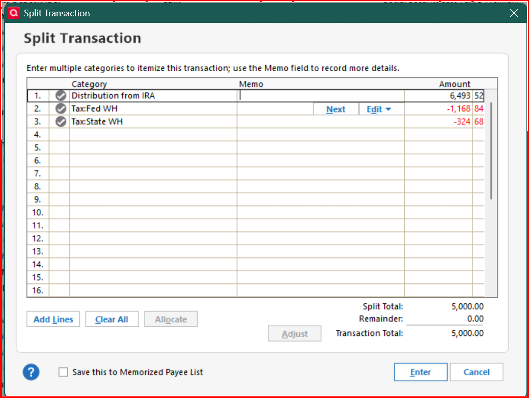

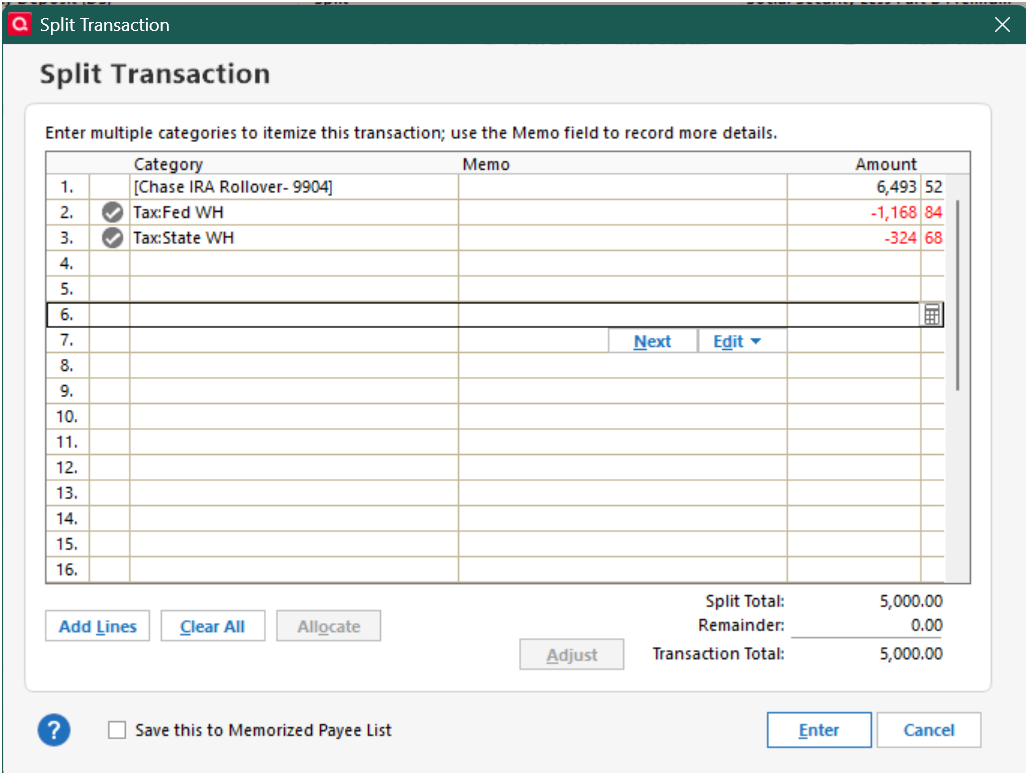

Here is what the splits should look like -
Jim's Method -
My Method -
The difference is the first split line. For Jim's method, the first line is a transfer from the IRA, which means you will need to delete the transactions that were downloaded from JPM for the distribution in the IRA.
In my method, you don't need to delete the transactions downloaded to the IRA.
What ever method you use it is important to use a category that has the appropriate tax category attached to it.

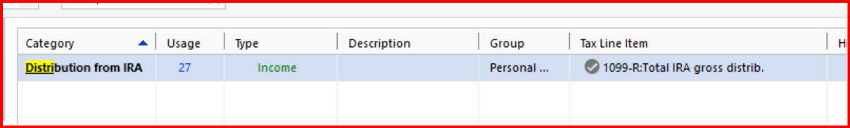

For my method, you would also need to set up an IRA Distribution category with the appropriate tax category assigned -

@Don32@ In Jim's method, the first line of split transaction is the transfer from the JPM IRA to the CU Savings account.
In my method there is no transfer, just offsetting entries in each account.
Bottom line, the only reason why it's done this way, for either method, it to have the distribution show properly in the tax planner.
The transactions in the JPM IRA do not show in the tax planner because it is a not a taxable account. In order to show the tax related transactions in the tax planner, the transactions need to be done in a taxable account (CU Saving account).
I agree with @CaliQkn's explanation. The two methods are equivalent.
With my method, the IRA ends up with one WithdrawX transaction which transfers the gross amount to the taxable account. This replaces the 3 downloaded Withdraw transactions, which add up to the same amount. Quicken knows the correct tax treatment for the transfer from the IRA's Tax Schedule setting for transfers from the IRA.
With @CaliQkn's method, you keep the downloaded Withdraw transactions in the IRA and give them a Category like "IRA Distribution," with no Tax line item. In the taxable account, the line in the split Deposit for the gross amount gets a Category that has the correct tax line item for the gross distribution. Because they are separate transactions rather than a transfer, you must make sure the total amounts are the same on both sides.
