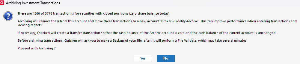

Quicken's archive process worked reasonably well for me this week, in an account with a very high level of trading activity. I was glad to see that even though I "hid" the archive from my account list, I am still able to use it for current-year reporting. The register is still slower than I would like, when entering transactions, but it's much more tolerable.
I create a new Quicken file each year, and at the end of this year, I will probably also apply the procedure in which I transfer open positions (and their cost bases) to a new account. This workaround has worked smoothly for me in the past (I have done it every couple of years in the past). Unlike many users (I suspect) I will then delete the old account from the current-year file; doing so allows me to delete a large number of option securities with expired CUSIPs (options are a significant contributor to the transaction volume indicated in this screenshot).
