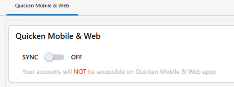

I also have issues with income reminders changing for no reason. I have deleted and reassigned and it will work fo a while and then it happens again for no reason. I use the paycheck wizard to set up my paychecks.
- Are you Syncing to Mobile/Web?
AND - do you actually use the Mobile app on your smartphone or the Quicken on the Web browser-based app?
The Sync process has been suspected of a number of weird happenings with Quicken. It's possible your problem is caused by Sync. Turning off Sync might prevent this issue from reoccurring.
If you answer "yes" to the 1st question and "no" to the 2nd question, turn Sync off completely. You don't need it. The Sync process should only be used in conjunction with the Quicken app for Smartphones or the Quicken on the Web browser app. It cannot be used as a replacement for backing up and restoring your Quicken data file.
If you answer "yes" to both questions, try to Reset Sync so that the current cloud sync file is replaced with a fresh complete copy
Do note that a full Sync process may take many minutes to complete.How to reset Sync to Cloud
• Log out of your mobile app, then do this on your desktop / laptop:
• Go to Edit / Preferences / Mobile and Web
• Click the "Reset your cloud data" link and follow the instructions until it is complete.
• Sync your desktop file to the cloud
• Now log back into your mobile appHow to turn off Sync to Cloud for the current data file
• Change the Sync radio button and set it to OFF0 - Are you Syncing to Mobile/Web?

Adding- this issue occurs both with Sync On and Sync Off. I have 0 accounts selected for mobile sync and Sync Off. Each OSU scrambles the reminders with category splits.
