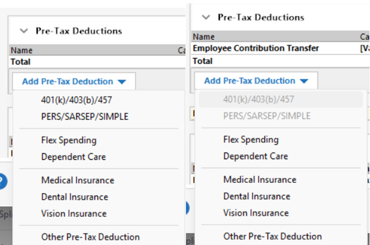

Income Reminder: I have a "split" (more than one earnings category). On is the large "regular salary" amount, the other is a small offset for an employer benefit.No matter what order I put them in or what categories I give them, the Income Reminder picks the smaller number, making it look like my estimated pay is nearly zero. It should be totaling all of the entries.
Aside from the change in behavior, for paychecks in general the whole approach seems incorrect: It shouldn't be using the gross income at all, and instead using the estimated deposit accounts values, which is the more accurate estimate for a paycheck.

Similar issue here. Paycheck reminders started appearing too high so my checking account balance projections are too high. If I open the reminder to edit this instance and all future reminders, everything appears correct. I click save and the issue is gone, but only for this session. The next time I open the file, it returns. I have run Validate and Super Validate, but that did not correct it.
This happened about a year ago, and the only solution that worked was to delete and manually rebuild the reminder - a pain. I reported it then and will submit a report again. PLEASE FIX THIS!!

Everytime I open Quicken on Windows, it shows all of my future paychecks as negative deposit in my checking account register, where it's basically only keeping the Fed Tax, Medicare, and Social Security deductions and nothing else.
But then if I go into a future paycheck in my register and click "Edit this instance and Future Instances," to go into the Paycheck Tracker it shows all of the correct pay and deductions line items with the correct paycheck amount. Then when I click Done in the Paycheck Tracker, you can tell Quicken is churning/calculating for a few seconds where the screen is flashing, and then the splits/amounts show up correctly for future paychecks in the register and in the Tax Planner. But then if I close Quicken and open it back up I have to do that again.
I've tried deleting the tracked Paycheck completely and re-entering it, but the issue persists. I'm thankful that just going through those few clicks fixes it for me so I don't have to go through restoring an old backup.
