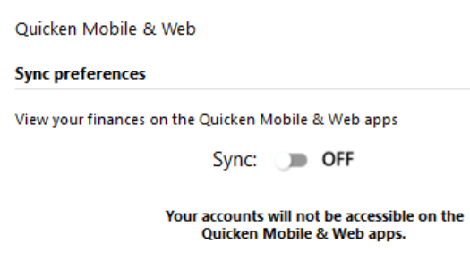

My Mobile and Web, The Sync is OFF.
I got too many issues years ago, so stopped using this Sync and Smartphone app as result.
Best Regards0 -

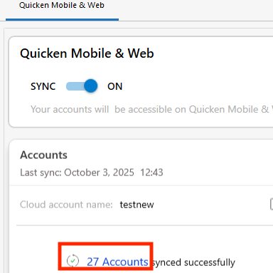

If you haven't already done so, I recommend navigating to the Mobile & Web tab, turning Sync on, and checking to see if it thinks any accounts are synced.
If it shows accounts synced, click on that blue link and unselect all the accounts that it thinks are synced. Once that is done, turn the Sync back off again, restart your Quicken, correct/recreate paycheck reminders as appropriate, and test to see if the issue is resolved.

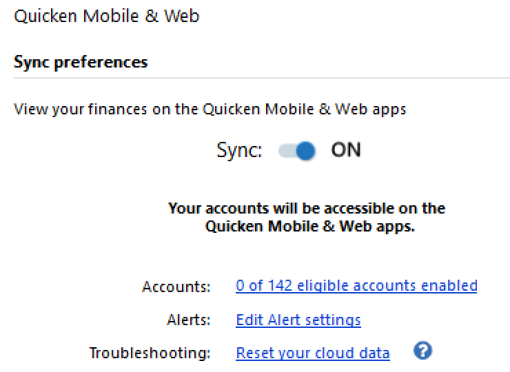

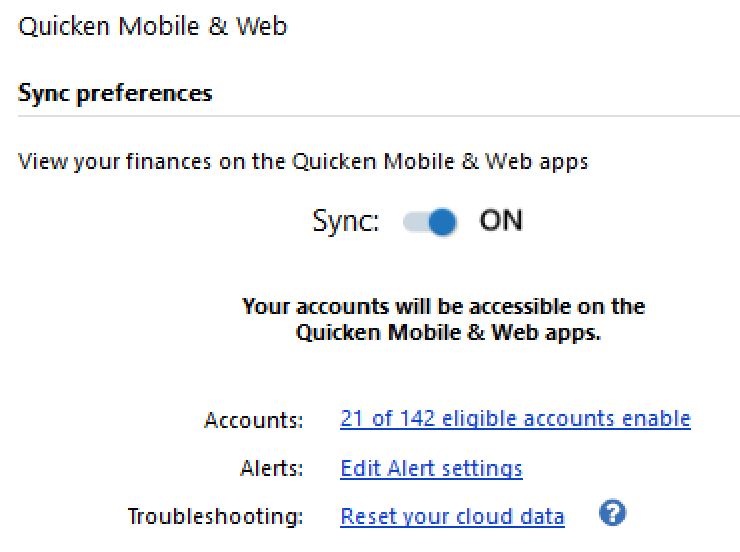

I'm afraid to turn the Sync ON as it might messed up with data file and data feed accounts
this is what I currently have
[Edit - Removed Personal Information]
Best Regards0 -

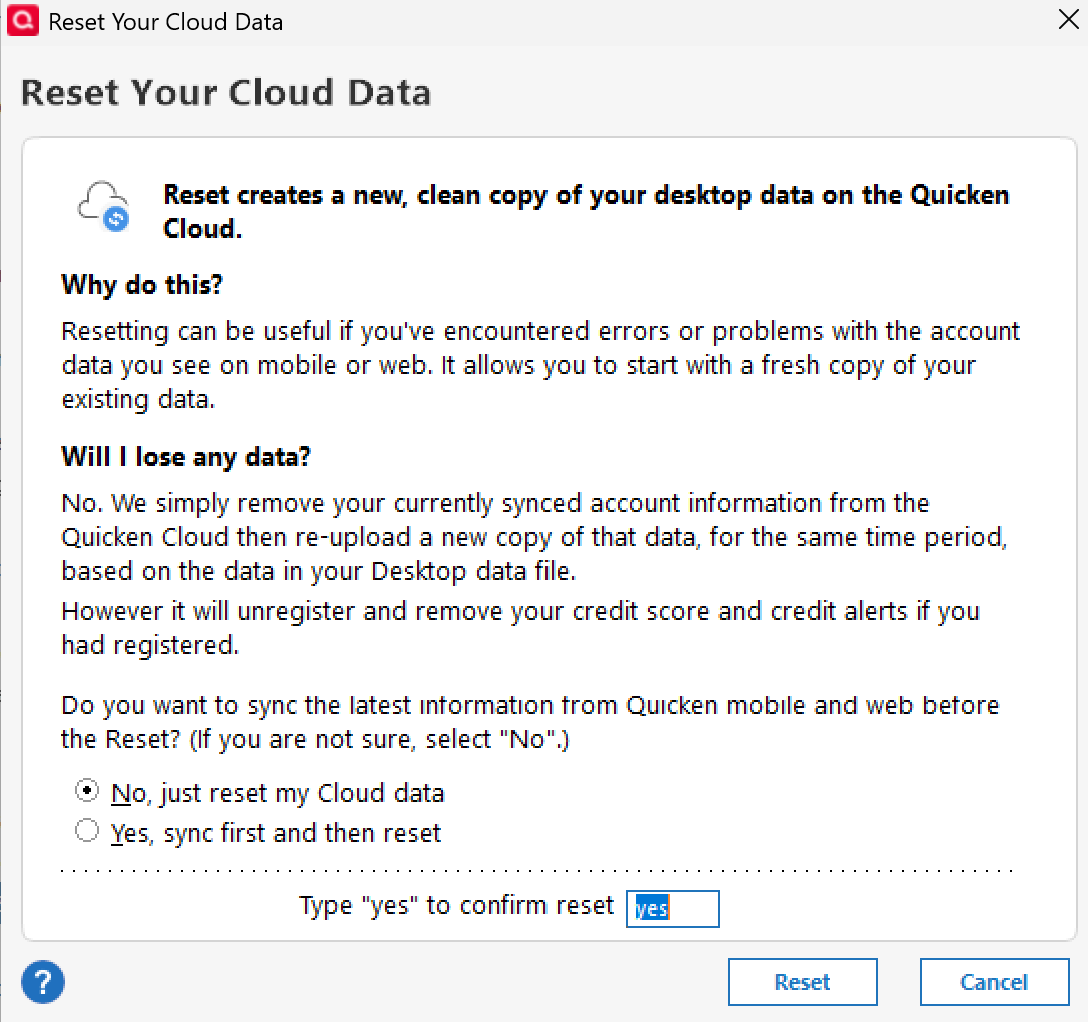

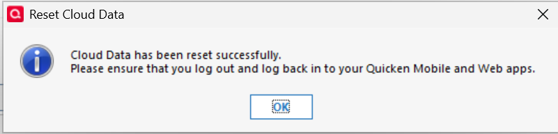

I have done all this while I run Quicken v 63.21

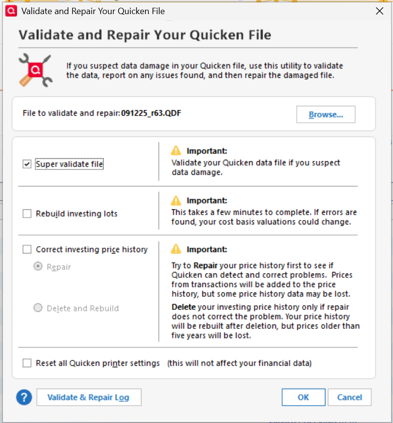

I run Super Validate and another backup just in case
this is upon the Reset

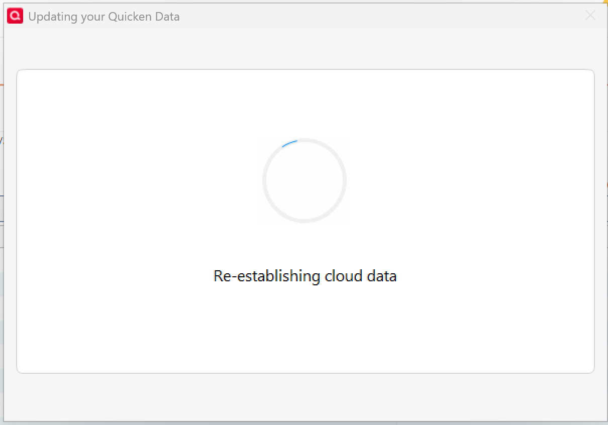

and after it went into Sync

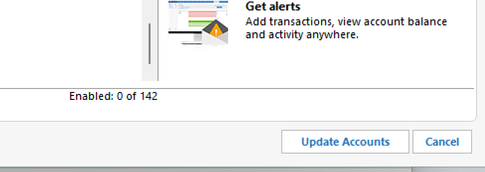

As result I got the
and
I edited to none the accounts
Quicken went for the Mobile update, took a few minutes

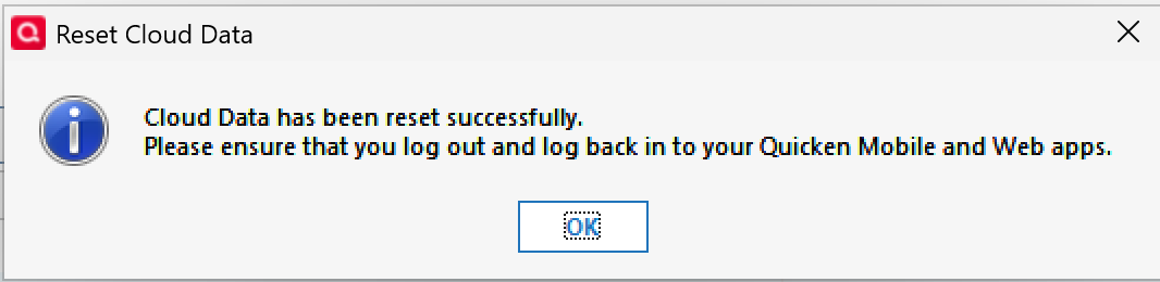

I run reset just in case again

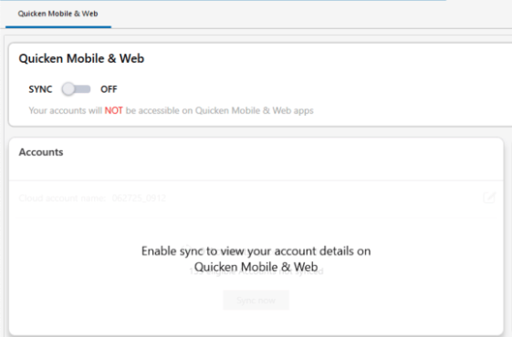

Now I turned Sync Off
Run again Super Validate
All Paycheck reminders are Ok, but I use v.63.21

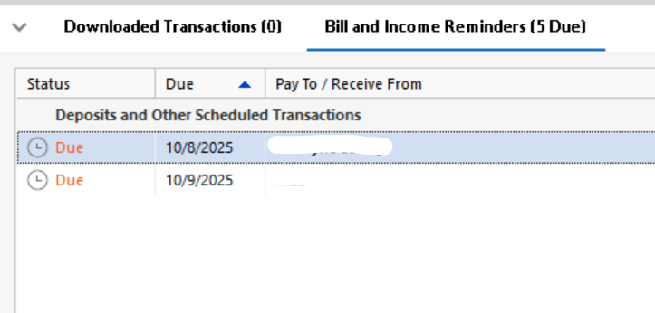

However, my old issue of missing Reminders per account remains
As you see I have 5 Due, but just 2 are shown.
I'll recheck tomorrow, I expect new transactions.
