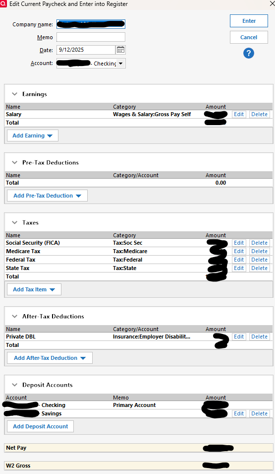

here are the screenshots. I've blacked out sensitive information such as dollar amounts and names. I highlighted the paycheck future trans in green in the account register.
Before OSU…

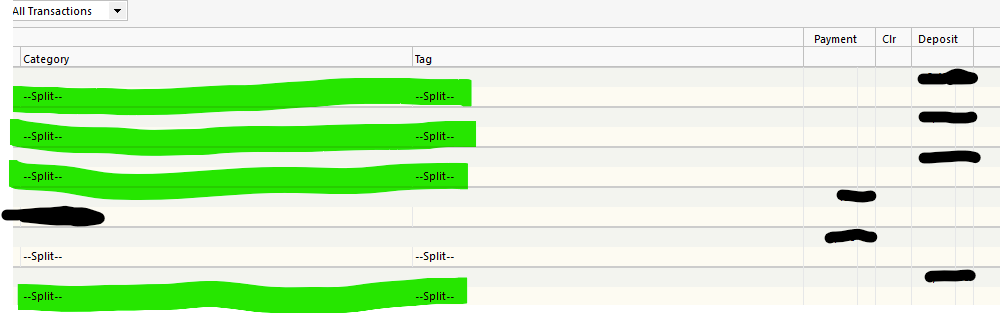

AFter OSU…
Hope this helps

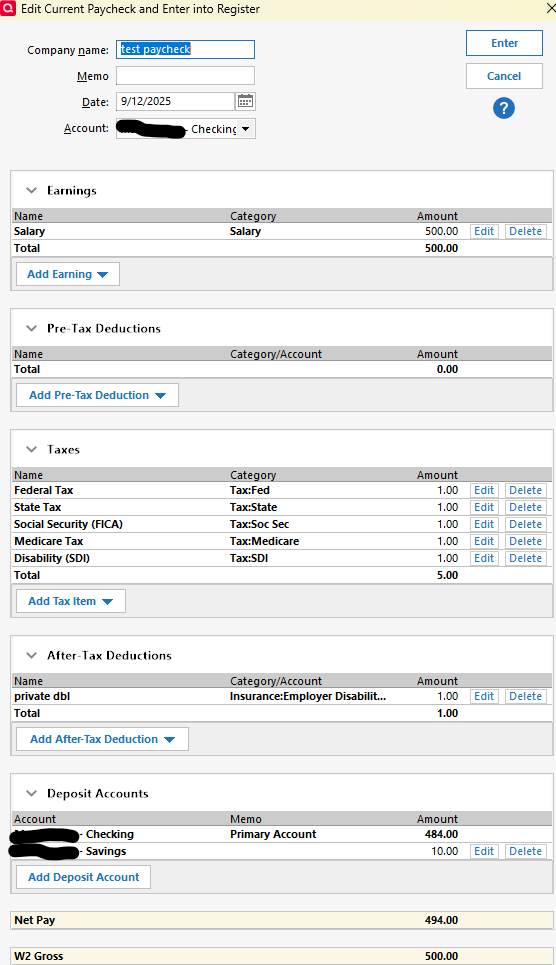

To provide a bit better detail of the paycheck transaction and observation details I created a completely new test paycheck reminder as follows -

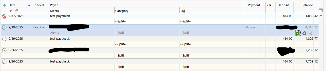

Here is the account register before OneStep Update -

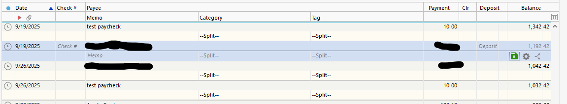

Here is the account register after OneStep Update -
The blacked out transactions above are my live paycheck transactions. You can see the activity of my "test" paycheck. This is a bug.
Please noticed yet another issue above. The "past due" test paycheck transaction in the before OSU screenshot. It disappears after OSU. That is another bug.
