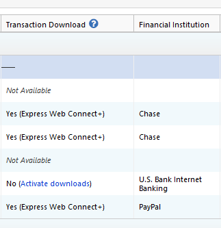

Thank you for sharing your experience. To better assist, please provide more information. Which connection option are you using with Merrill Lynch? You should be able to see this by navigating to Tools>Account List. The Financial Institution column should show the connection option you are using for the account.

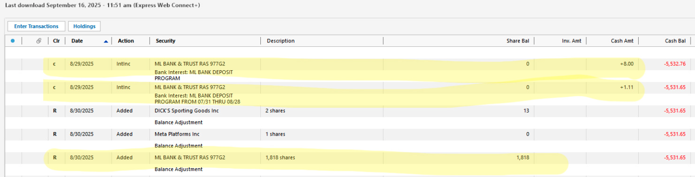

Please post a screenshot of what these transactions look like in your Quicken (with any personal information redacted). That may help to identify why the holdings aren't reflecting properly. If needed, please refer to this Community FAQ for instructions on how to attach a screenshot. Alternatively, you can also drag and drop screenshots to your response if you are not given the option to add attachments.

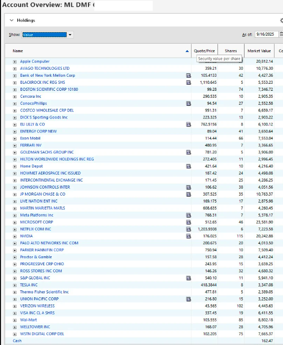

I am sending screen shots from one of 12 accounts that I have at Merrill. The holdings in the account, the transactions in the account, and the printout from Merrill Lynch that shows what they show as my holdings. Clearly, the data from Merrill is not being accurately transmitted to Quicken Windows.
Hopefully this will clarify what I am experiencing.
Dennis Freeman

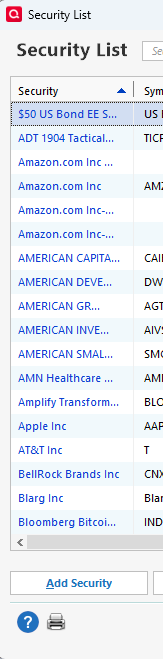

First, navigate to Tools>Security List. If the correct holding is not already showing there, please add it. You should see an Add Security button near the lower left corner of the Security List window.
Once the security is in your Security List, you would then need to make sure it is associated with the proper transactions in your investment account register. To do this, backup your Quicken file, then find those transactions, select Edit, and make sure that the correct security is reflecting in the Security name field.

I started with one of my ML accounts. Went to the Securities List, and the holdings are already there. They have no associated ticker symbol associated with them as they are classified as OTHER. Since there is a discrepancy between the cash holding shown in Quicken does not match what is on the website, I assume that ML Bank Deposit Program deposits are going to cash. If I click on that holding in Securities list it takes me to the holding and indicates there is just a few dollars in it.
That said, How do I get that holding from the Securities List to show up in the specific account that holds it?

To get the holding to reflect in the account, you would need to have transactions associated with that holding. If you are able to find the transactions in the account register, you would need to edit the transactions and fill in the correct security in the security name field.
