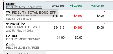

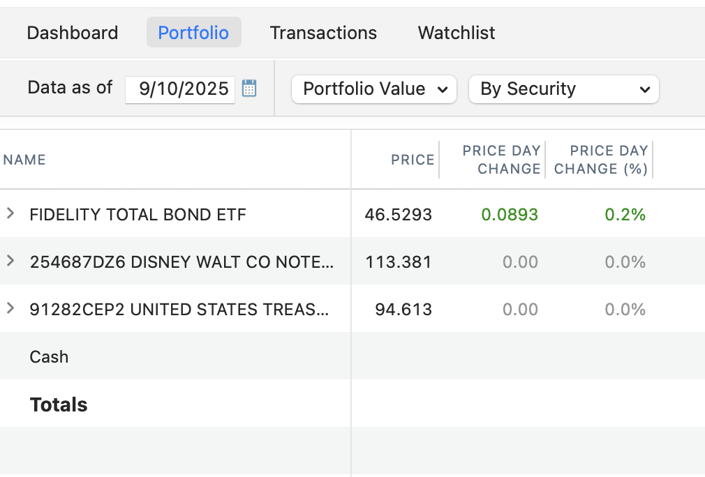

    In 3 accounts, these securities in not showing at all in the balance. THey are also not being included in the Cash balance. Below is an IRA account that:
    This is what the Fidelity site shows for that account:

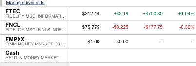

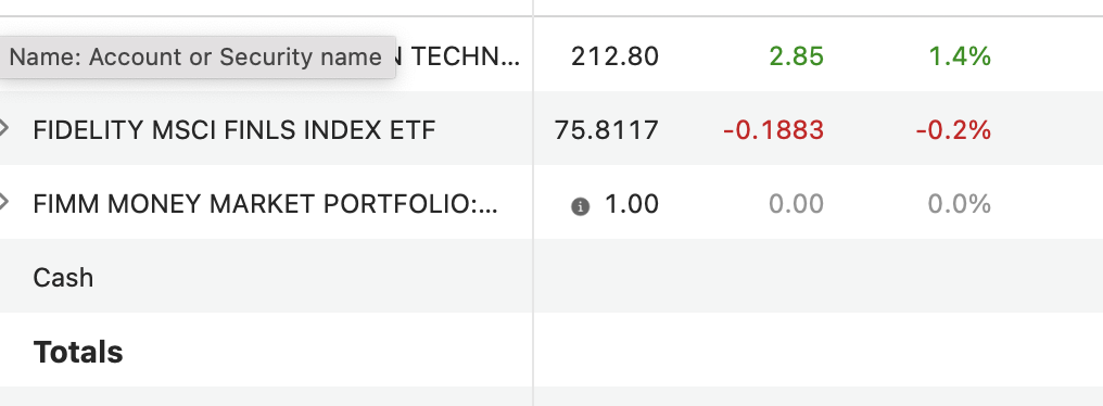

    A Roth IRA account correctly shows (FMPXX is FIMM Money Market Portfolio):
    This is what Fidelity shows for that account:
    One caveat, for this account, a dividend reinvested in FMPXX was classified in the download as a regular dividend after the 8.3 update and was included in cash. I manually reclassified classified it to Reinvest Dividend and it moved it. Dividends in the other accounts also downloaded as Dividend Income and were added to cash.
