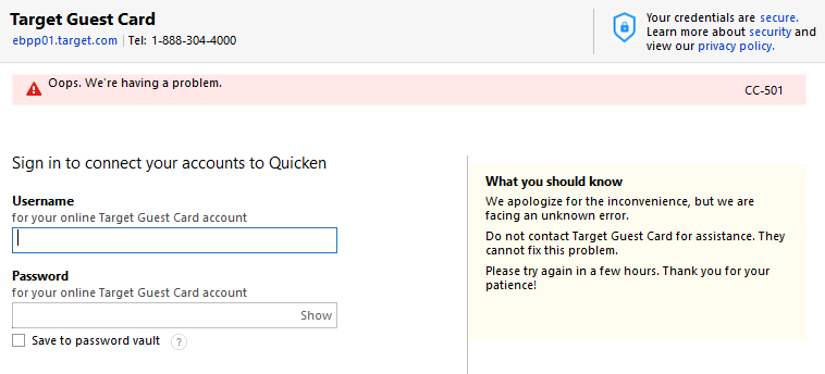

I just tried again, and at least in my setup, it is not.
Hi @DLCPhoto,
Thank you for checking back in and for sharing the screenshot. I do see that the error you’re encountering is a CC-501. This type of error generally indicates that Quicken was unable to connect to the financial institution, and it’s most often caused on the bank’s end blocking Quicken’s connection.
Usually, these errors are temporary. The best next step is to wait 24 hours and then try again. If the error still persists after that timeframe, we recommend contacting Quicken Support directly so they can review your logs and escalate if needed.
You can find more information in this support article.

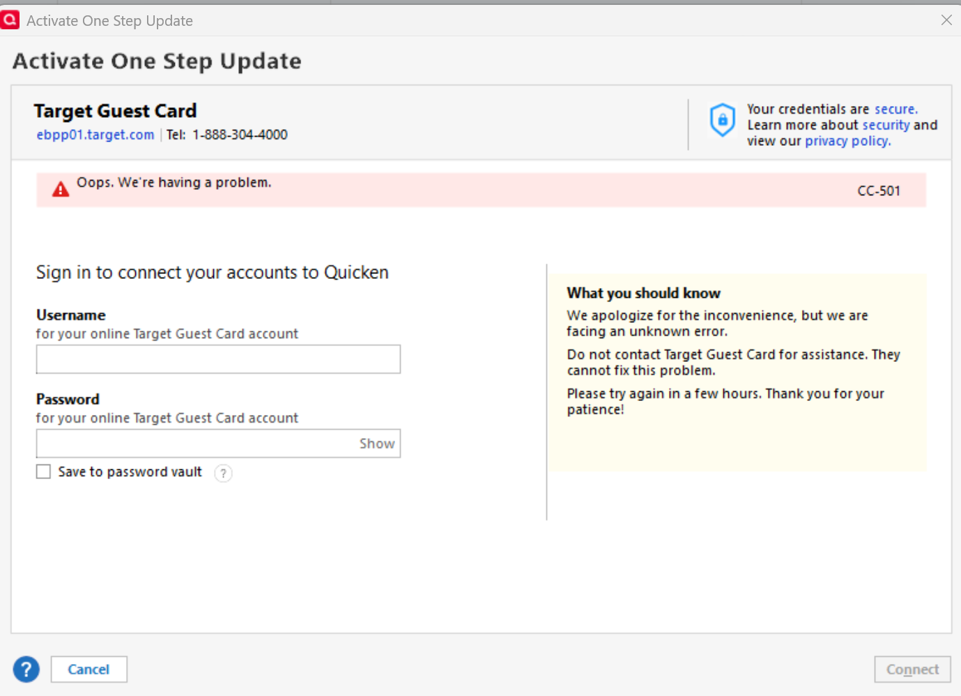

My Target card simply stopped downloading. I tried a "reset" (didn't work) and then disconnected followed by trying to Activate One Step Update which gave the following results (clicking "Next" brought me back to the beginning screen):
This has been going on for weeks now. My Username and Password are correct and work with the Target website.
Here is my screenshot:

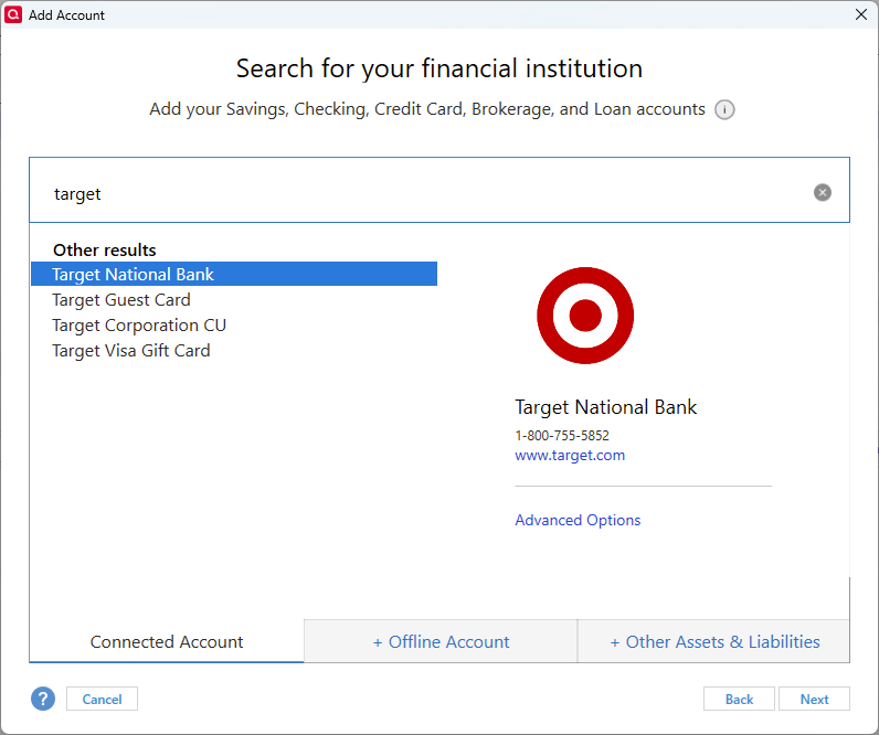

Hi quicken users, Just wanted to share that I was able to successfully connect my target circle card (red card) by connecting to 'Target National Bank' instead of Target Guest Card (same personal log-in credentials). (I used the 'add account' feature in Quicken, then just linked it to my 'existing account' in quicken and it connected and updated my target card account in quicken as normal). Just fyi .. I had tried this several times over the past few weeks and it didn't work, but today it was successful. Hope this is helpful…

Ok, so when I went to my existing Target account in Quicken, and chose the option to set up online access, but there is no opportunity there to change it to Target National Bank.
So I went to Add an Account, which did give me that option. I entered my login info, got the text to get the code, and it then connected, giving me the opportunity to link it to the existing Target account already in Quicken.
It appears I'm good to go. And it also makes me wonder if this could have been done weeks ago, since the problem was not using the correct Banking ID/server.

Target Card Connection Solved Today 9/22/2025
Up till now my Target download was connecting to ebpp01.target .com which hasn't worked at all for some time now.
TODAY I used Tools \ Add Account and selected Target National Bank (www.target.com):
- I entered my Target Card username and password
- It found my Target Card account
- It offered to Link to Existing and so I chose my Target Card already in Quicken
- A Perfect Update followed.
Now my Target Card "Account Details" show "target.com" and no longer show "ebpp01.target.com"
No longer having any Target Card problems at all.

I followed the suggestion by AAlbury above and it worked for me. I have Quicken Classic.
- Disconnect your Target account
- Edit account details
- Choose the Online Services tab
- Disconnect
- On the Tools menu
- Add Account
- In the popup window's search bar, search for Target National Bank
- Then follow through with the rest of the procedure.
I was sent a code and entered it, but I'm hoping that's the only time I have to do that. All of my transactions downloaded. I did another update, knowing I wouldn't get more information, and I did not have to enter a code.
Thanks to AAlbury for finding the solution! At least it worked for me.
