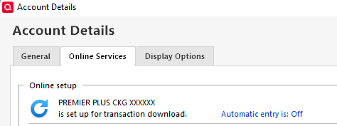

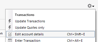

If restarting the program does not correct the issue, then from the register of the problem account, please click the gear icon, and choose Edit Account Details.

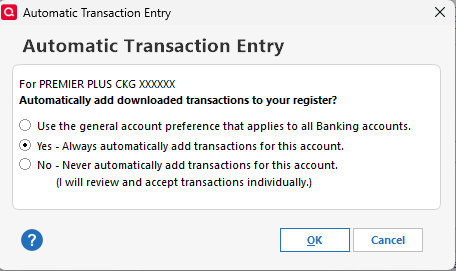

In the Account Details window, select Online Services, and click the Automatic entry is: link.
If Automatic entry is: OFF, turn it ON.
If it is ON, Turn it OFF, then close and reopen Quicken and turn Automatic entry back on.
Check to see if the downloaded transactions are now visible in your register.
