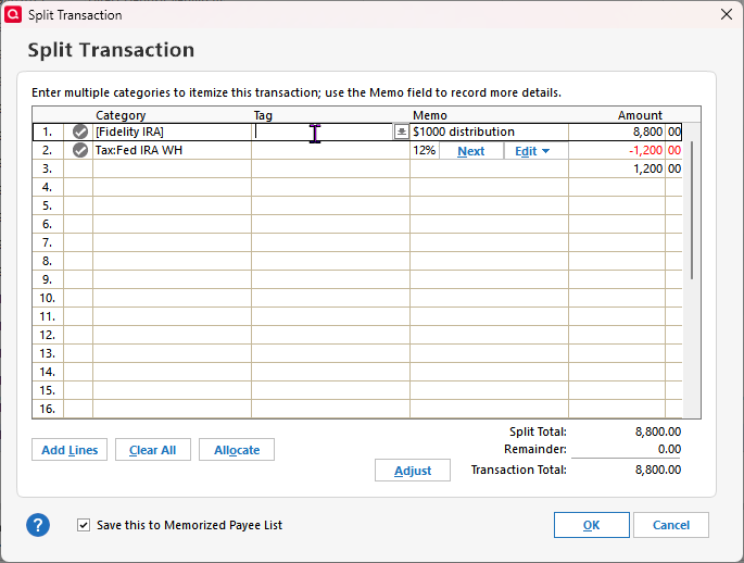

If taxes are withheld from the distribution, the process is more complicated because you must record the gross distribution as well as the withholding(s) in the taxable receiving account. To do this, go to the receiving account and:
1) Enter a Deposit transaction for the net amount of the RMD as a positive number.
2) Split the Category:
- Line 1 of the split: Category = the IRA account name in [square brackets] for the gross amount as a positive number. This will create a transfer from the IRA.
- Line 2 of the split: Category = the Fed tax withholding category that you use, as a negative number.
- Line 3 of the split: Category = the State tax withholding category that you use, as a negative number.
- Total of the split: Must equal the net amount of the deposit.

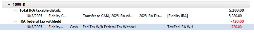

I was playing around with it for a few minutes.
I ran the Reports>Tax>Tax Schedule report but it did not show the 1099-R IRA federal tax withheld. It only showed the transfer from the Fidelity IRA under — Total IRA taxable distrib.
Then I clicked on the Customize widget in the upper-right of the report, and then clicked on "Accounts" and noticed the Fidelity IRA did not have a a check in the checkbox next to the account name. After I checked the box the withdrawal showed up in the report.Once I clicked ok the — IRA federal tax withheld amount showed up, as you can see below.
The Tax withdrawal shows up as negative (red color) I assume that is correct?This makes sense to me since this is exactly how it would show up in the Fidelity Statements, rather than creating fake transactions in the CMA account which would not match the statements from Fidelity.
I have not tested this on the Mac Version, but if I am missing something, I would appreciate feedback.Note: if you don't save the report the accounts are "unchecked" from the customize report setting which means when you run the report again the IRA federal tax withheld will not be included in the report.

@Jim _Harman I see what you mean now, and I really appreciate your help — your post cleared up a lot.
I just wanted to suggest a small tweak for the Windows version.
In Step 1, there’s really no need to enter the net amount first. Quicken automatically carries that number into the Split window, but since you’ll be entering the gross amount there anyway, it just ends up being overwritten.
So instead of entering the net amount, you can either leave the Deposit field blank or enter the gross amount right from the start. For example, if the gross distribution is $10,000 and the net is $8,800, typing $8,800 first just makes Quicken prefill that value in the split — and you have to change it again to $10,000 later.
Step 1 could say something like:
Create a new entry in the register, add the Payee and Memo info (optional), set the category to the [Transfer from account], and either leave the amount blank or enter the gross amount. Then continue with the split as you described.Everything else you wrote works perfectly once that’s clarified. Thanks again for taking the time to share those steps — they really helped make sense of the process.
