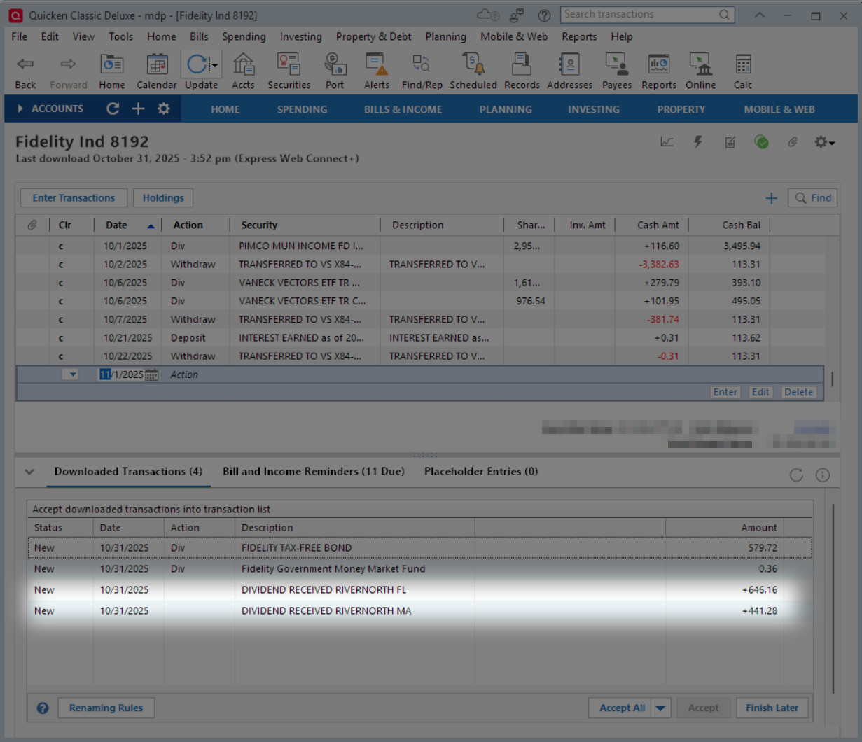

Fidelity EWC+ reinvested month end dividends handled wrong
Using Fidelity DC connection, Quicken clearly showed taxable reinvested dividends for an investment account that has a linked cash account as transactions in the investment register with the Action = ReinDiv. These show up as taxable transactions in the tax reports.

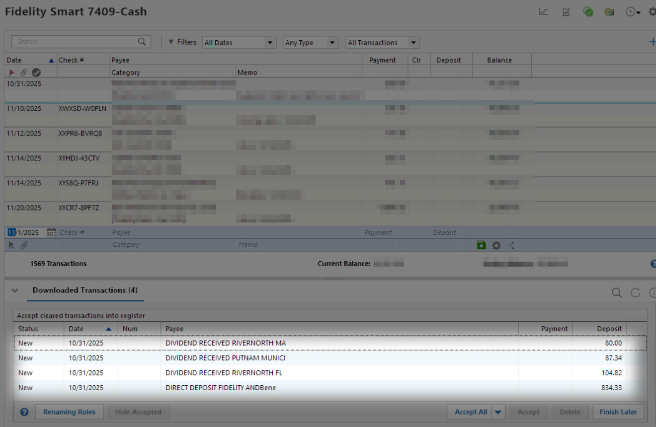

Under Fidelity EWC+ connection, Quicken confusedly shows transactions in the linked cash account adding the dividend amount without any category designation for a taxable Dividend. Then in the corresponding investment account, Quicken adds a BoughtX transaction for the same transactions. The end result, is no taxable event is recorded for what should be taxable dividends.
For the core MMF, Quicken incorrectly labeled the core MMF dividend transaction for the account that has a linked cash account with action DIV instead of a DivX to have the cash show in the linked register. From what I'm reading Quicken/Fidelity has many months of corrections to make before EWC+ works with the equivalent features as DC.
Using Fidelity EWC+ connection, Quicken shows dividends received for some securities the in regular investment accounts with the comment "DIVIDEND RECEIVED…" with no Div designation to correctly categorize the dividends. Please make this work like the DC connections which correctly reports a DIV transactions. The DIVIDEND RECEIVED comment is so truncated, it can be ahrd to determine for to security the dividend belongs. See example below:
Can Quicken please return the behavior of the DC connection to the EWC+ connection and treat dividends correctly all accounts?

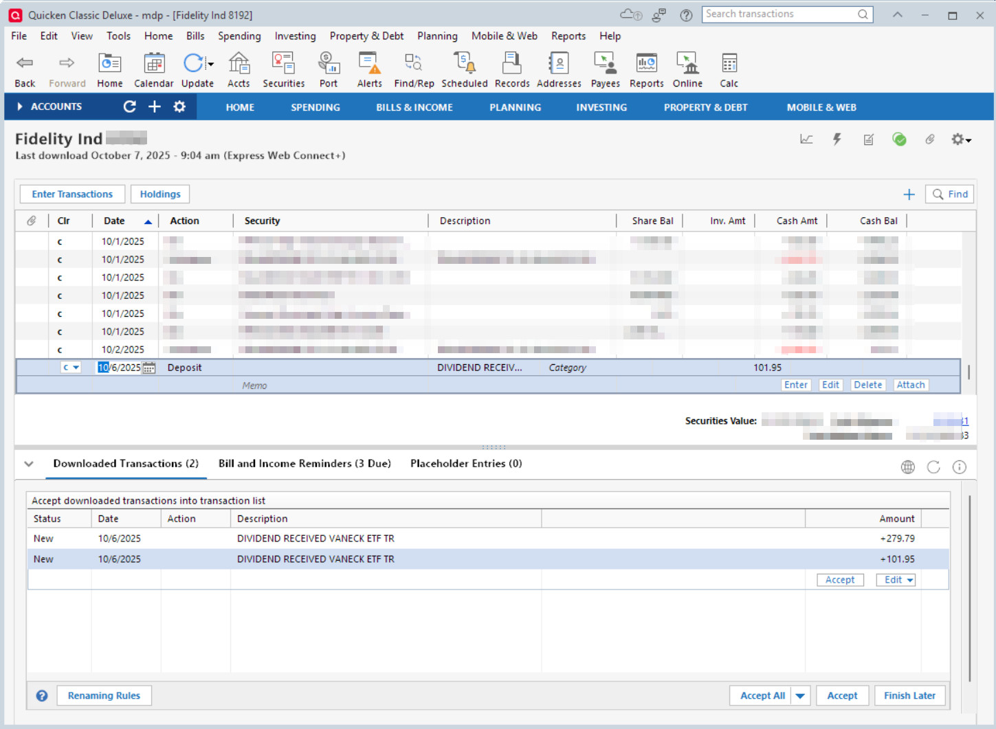

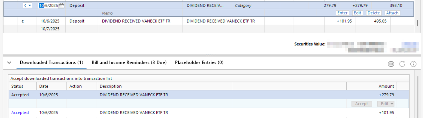

The problem still exists for the EWC+ connection. This problem is evidently showing up for reinvested and nonreinvested dividends into regular Fidelity accounts. For the following example pictures, nonreinvested dividends into a regular Fidelity investment account are treated as deposits instead of action=Div and the security name is truncated in the transaction description with no actual security associated with the transaction action. In the pictured case below, 2 downloaded transactions are listed truncated as "DIVIDEND RECEIVED VANECK ETF TR" when both transactions are for different securities. On the Fidelity website, the Activity for these transactions have the full descriptions "DIVIDEND RECEIVED VANECK ETF TRUST HIGH YLD MUNIETF (HYD) (Dividend)" and "DIVIDEND RECEIVED VANECK ETF TRUST CEF MUNI INCOME (XMPT) (Dividend)" which Quicken is truncating in the description so that it is impossible to determine the correct security matched to the amount.
The correct securities as listed in Quicken should have been "VANECK VECTORS ETF TR HIGH YLD MUN ETF" and "VANECK VECTORS ETF TR CEF MUN INCOME E".
Accepting the dividend transactions, treated them as Deposits with no security associated when they should have been treated as action Div with the correct securities associated.
The DC connection correctly treats the dividends with Action=Div and the proper security name in the transaction.

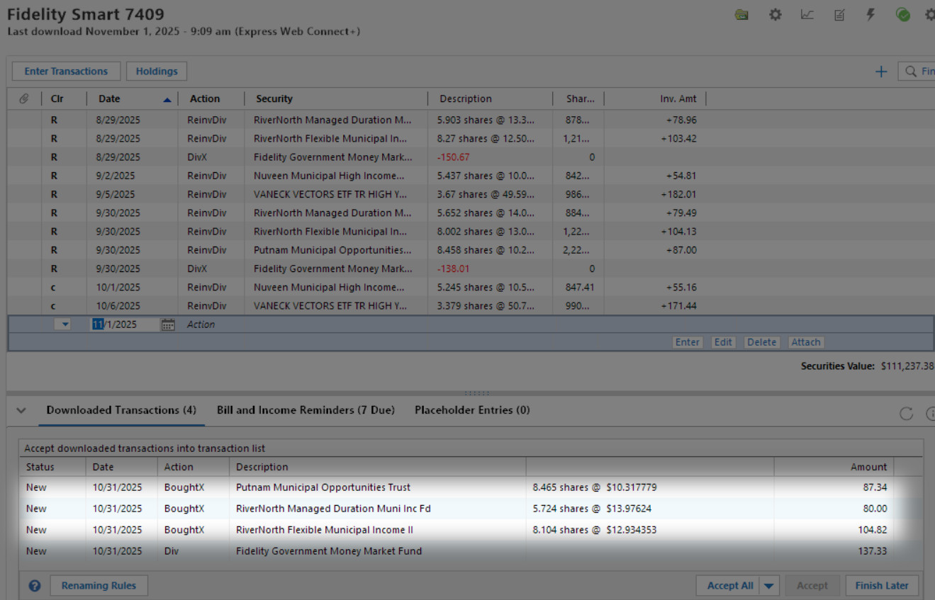

Before accepting the download:
After accepting the download:

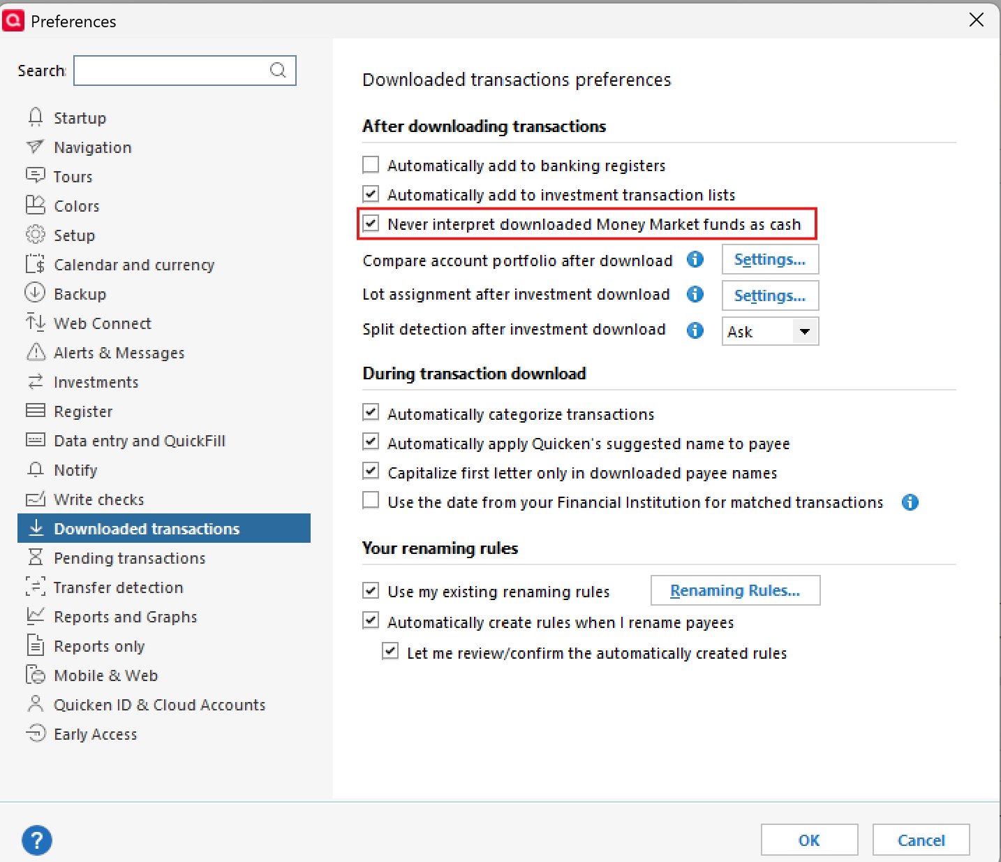

Hello everyone,
A member of our escalation team has provided guidance for users experiencing this issue. Please follow the steps below to help resolve the problem. Be sure to back up your Quicken file first to protect your current data.
Steps to Follow:
1. Backup
- Save a backup of your Quicken file.
2. Adjust Preferences
- Go to Edit → Preferences → Downloaded Transactions
- Check “Never interpret downloaded money market funds as cash.”
- Click OK
3. Force Transactions
- Run a One Step Update (OSU) on the affected accounts.
- Accept downloaded transactions.
- Review any prompts and make edits as needed.
4. Restore Preferences
- Go back to Edit → Preferences → Downloaded Transactions
- Uncheck “Never interpret downloaded money market funds as cash.”
- Click OK
After completing these steps, you should be able to reset the cash representation for the affected accounts or funds.
Additionally, we are actively working on an official fix for an upcoming update release.
Please let us know if these steps resolve the issue so we can proceed accordingly.

A similar issue occurs for a linked cash investment account where reinvested dividends are incorrectly treated as a Deposit with no security associated into the cash part and and BoughtX for the security into the investment part. The end result is that dividends are not recorded for reporting or tax planning purposes.

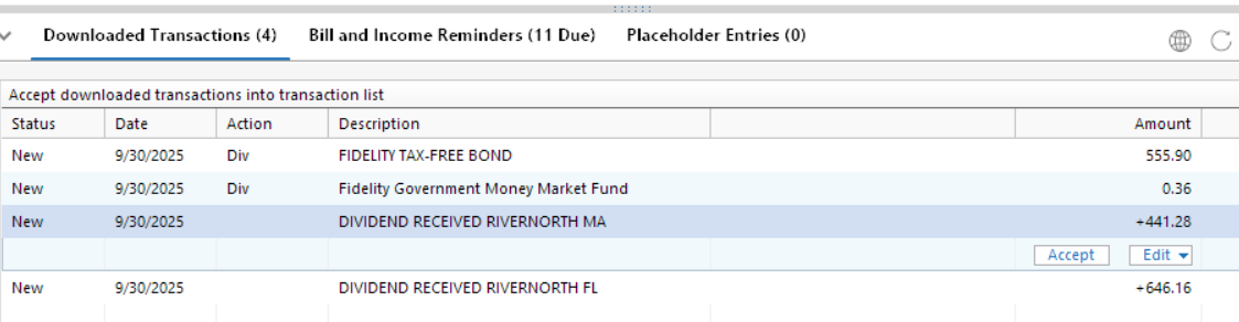

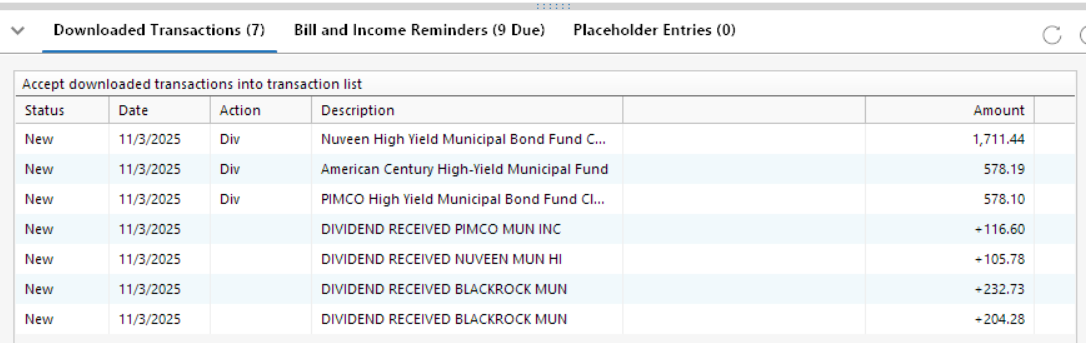

As of 11/4/2025, reinvested dividends into a non-IRA Fidelity account that has a linked cash partner are still incorrect. Here's a list of month end dividend treatment by Quicken.
Dividends into a linked cash investment account:
This month end's download brought a reinvested dividend into the linked cash partner incorrectly as deposit transaction with Payee "DIVIDEND RECEIVED NUVEEN MUN HI", which is truncated name of a security, for $55.51. In the investment account, a BoughtX transaction showed for security "Nuveen Municipal High Income Opportunity Fund" for $55.51. The end result is that a deposit for an incorrect partial security name does not reflect dividend income for the actual security so that reports and tax planning are incorrect for this security. Workaround: Accepted the BoughtX transaction and changed it to a ReinvDiv. Deleted the "DIVIDEND RECEIVED…" transaction in the partner linked cash account.Dividends into a Roth IRA account:
Reinvested dividends downloaded for a Roth IRA account, downloaded correctly with Action=ReinvDivDividends into a regular non-IRA account:
Dividends for a non-IRA Fidelity account that has no linked cash partner downloaded with some correctly showing with Action=Div and most incorrectly showing no Action and a truncated Payee starting with "DIVIDEND RECEIVED…" . The end result is that the incorrect dividends are not recorded as dividends in Quicken and are not shown in Reports and Tax Planner. Workaround: Manually fix the incorrect ones i.e. work for Quicken instead of Quicken working for the end user.These problems have existed ever since the EWC+ cutover and have been reported. Similar dividends treatment is displayed at every month end so far.

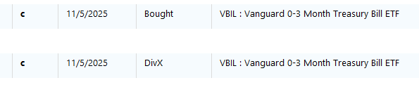

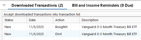

What is the intent of Quicken interpreting securities as cash? Is it only intended for core positions? In which case the only mutual funds for this are SPAXX, FZFXX & FDRXX as far as I can tell.
By the way, I believe you can tell a money market mutual fund by its symbol, 5 letters ending in XX.
From Fidelity AI chat:
"To view your core position, log in and look for the Positions tab in your Portfolio Summary. Each account has its own core position. When you have uninvested cash in an account, the core position is listed as "Cash" in the positions list. Clicking on "Cash" will display more detail about your core position. Depending on the core positions available for your account, you may see detail for SPAXX, FZFXX, FDRXX, FDIC-insured deposit sweep, or USD, etc."
