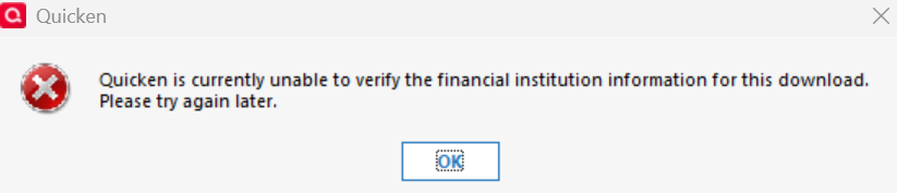

For the past 10 years, I've been manually downloading an .ofx file from my Merrill Lynch 401k to Quicken with minimal issues. Suddenly on Saturday, September 27th, 2025 I received the following error. "Quicken is currently unable to to verity the financial institution information for this download. Please try again later." This issue is continuing to persist. Does anyone know how to resolve?

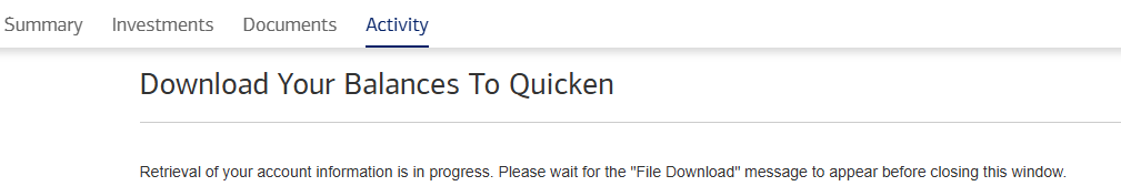

Merrill Lynch no longer supports Web Connect/QFX file importing into Quicken even though they still allow exporting of the QFX file (which is a mistake on their part) as I have explained here:

The 401K accounts have a different URL/login that only every had Web Connect/QFX file exports. That has now been disabled.

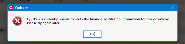

Quicken is unable to verify the financial institution
The "unable to verify the financial institution" error occurs when your bank no longer supports Web Connect authorization in Quicken, even if they still provide QFX downloads.
This happens because Web Connect files require access to online services to validate the file and transactions for security purposes. The verification process is separate from file download capability - banks can provide QFX files but discontinue the authorization service Quicken needs.
This issue can only be resolved by contacting Merrill Lynch Benefits Online directly, as they control Web Connect support and provide the QFX file.0 -

I suspect that the people you were talking to were downloading the QFX files from www.ml.com not www.benefits.ml.com.
After all it is still active for Web Connect:055500555005550Merrill Lynch Investmentshttps://www.ml.com/1-800-637-7455https://www.ml.com/ACTIVEINVESTMENT&DIRECTINVESTMENT&WEB-CONNECT BANKING,CREDIT,ACCOUNTINFO,INVESTMENT&EXP-WEB-CONNECTNOT_QBPNA
This is what they will probably discontinue in the future.
But they have already told Intuit to disable the one for the benefits site.
07791077910779zzz-Merrill Lynch Retirement Grouphttps://www.benefits.ml.comNAhttps://www.benefits.ml.com/login/login.aspxACTIVE NOT_QBPNA
